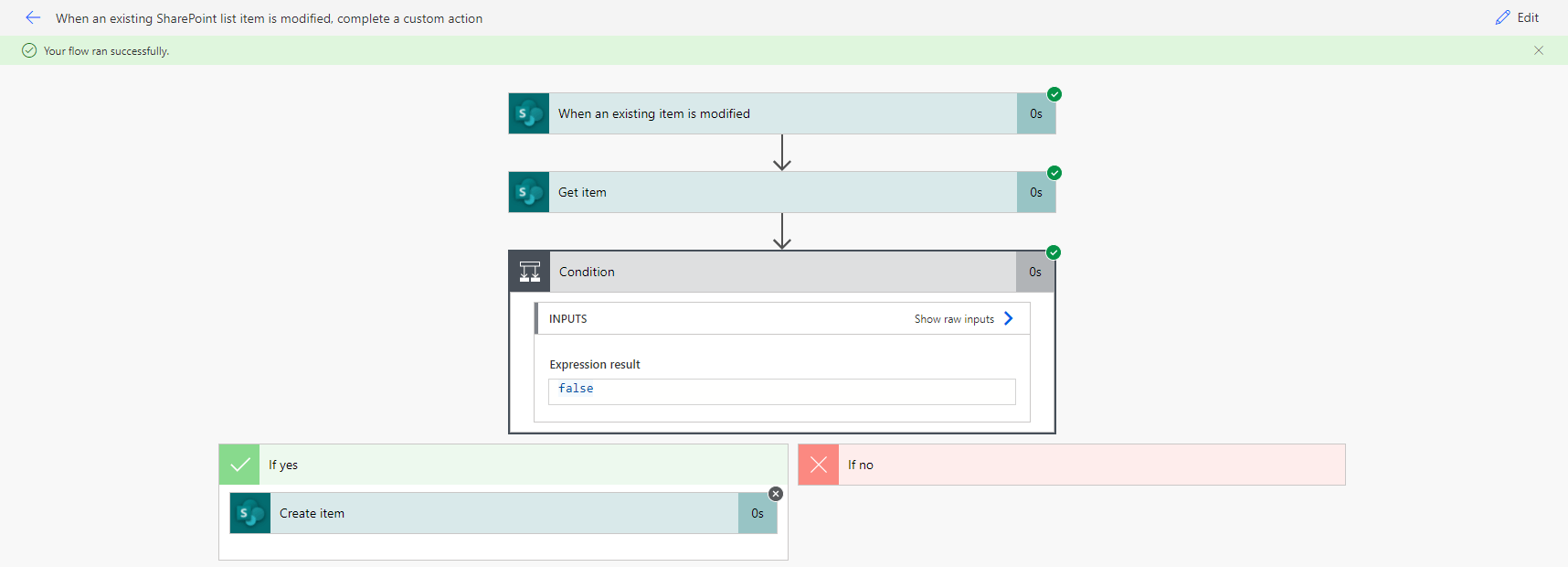

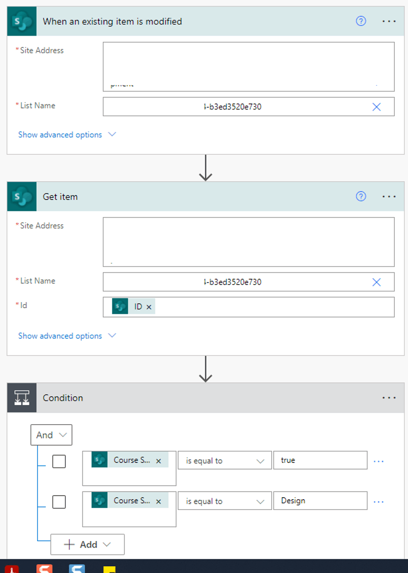

I am relatively new to using PowerAutomate, and I am creating a process flow that creates a SharePoint List item based on a status field within another list.
When there is a request received from Stakeholder and Business areas (Front-end), I will need to open a corresponding request on the (Back-end) once the project reaches a certain status. This relays information to our business analyst.
I have completed the flow and entered all Dynamic content to allow the list item to transfer all required data points.
When I test the flow, it shows all the steps succeeded, but the corresponding request is not created in the (Back-end) list as I am expecting.
I am unsure what I am missing. Can someone please help?

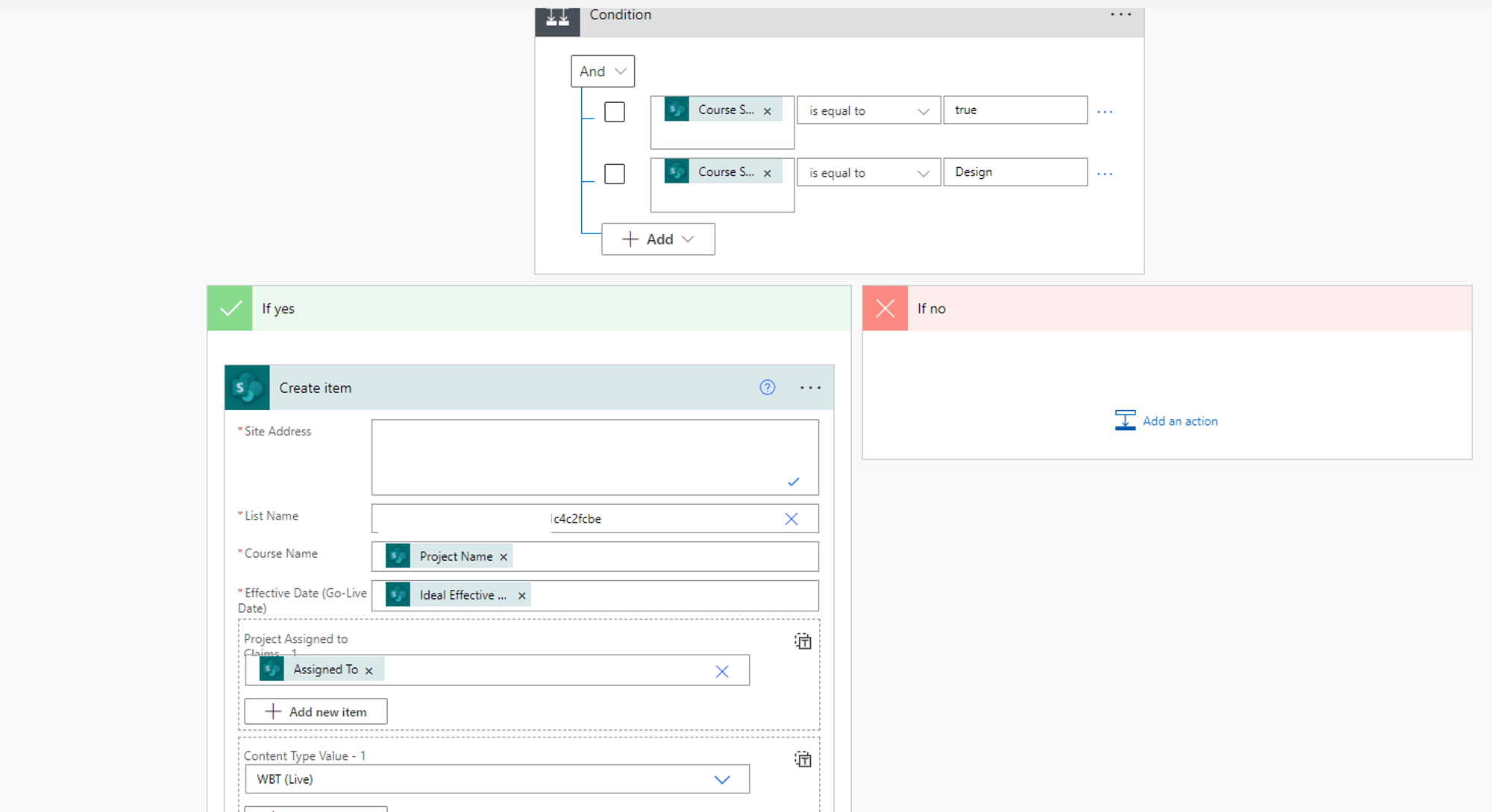

    The workflow looks good to me as well. So my idea is the Condition you have setup is not satisfied.
    I can see, you did not setup any actions if the condition fails.

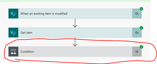

    Could you click on this part:
    And see what's the result for this condition, is it true of false?

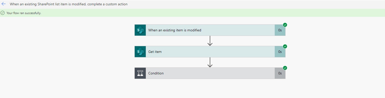

    2022-01-25T00:21:59+00:00
    Thank you so much for the quick follow-up.
    Here is the image when I expand.
    To confirm, when I change the status to "Design," a copy of that ticket should be created/mirrored into a different list.
    The possible issue is that the condition is not being met, causing the change not to occur. Do I understand that correctly?

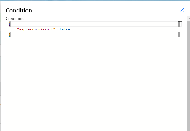

    2022-01-25T00:49:03+00:00
    Hi Chris,
    Yes, as you can see the Condition return value False, which means the requirement you've setup was not met.
    You can click on Show Raw Input, and it should give you a clear view on which requirement is not satisfied.
