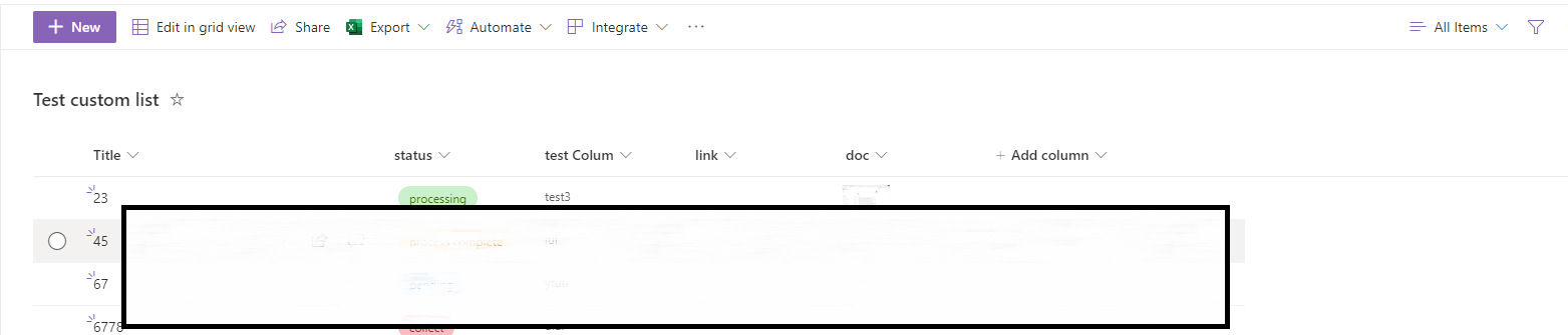

    Based on my test result after creating a custom list it seems I cannot meet same behavior as lie yours. See image below for your reference:

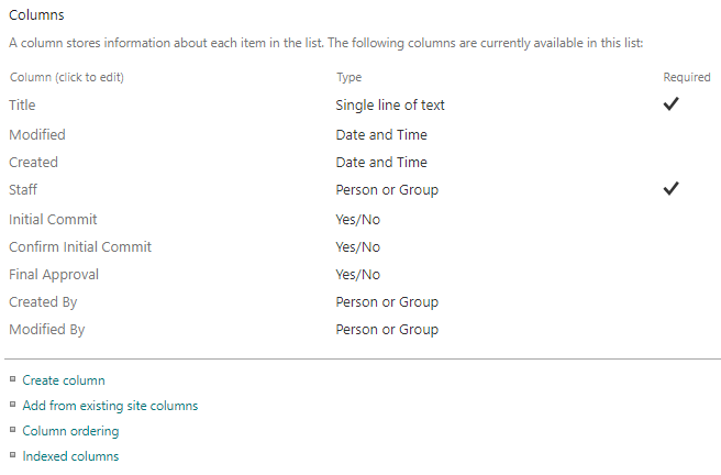

    Below is my List's columns:
