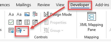

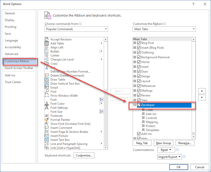

    First, if you don't see a Developer tab on your ribbon, you need to enable it. It's hidden by default. Go to File > Options > Customize Ribbon. In the right-hand list, put a check in the box next to Developer and then click OK.
    Next, put the cursor in the table where you want to insert the value (in your screen shot, it would be in the Retention time cell of the table). Click the Developer tab to display its ribbon, and click the Legacy Tools button, the one shown in this picture:
    The dropdown that appears has two sections, Legacy Forms and ActiveX Controls. Click the first button in the Legacy Forms section, the one with ab in the rectangle. DO NOT use ActiveX controls, as they don't work with the IF field the same way.
    That inserts a text form field in the document at the cursor location. By default, the text form field has a gray shade, although you can turn that off by clicking the fifth button in the Legacy Forms group.

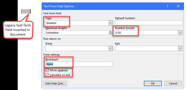

    Next, set up the properties of the field you just inserted, by clicking the Properties button while it's enabled. That opens the following dialog box:
    In this screen shot, I show the values I suggested in my previous reply. By setting the Type box to "Number", you ensure that the form field won't accept characters that aren't part of the number format. The Number Format of "0.00" means that whatever number is entered will be automatically formatted to two decimal places. The "Calculate on exit" means that any IF field that refers to this form field will be updated automatically when the field's value changes.
    Whatever you enter in the Bookmark box will be the "name" of the form field. I suggested "Input", but you could use any valid bookmark name, for instance "Retention". Whatever you put there, you must use that name in all of the nested IF fields where I showed {Input}. So if you do enter Retention in the Bookmark box here, then the IF field would look like {IF {Retention} <= 0.3 ... etc,
    When the property values are complete, click the OK button. If you need other places in the document to enter data, you'll have to insert form fields in those places too. Each one must have a unique Bookmark "name" -- if you use the same name a second time, that field will "steal" the name from the other field, which will be left nameless (not good!). Once the document or template is protected (as discussed in the next paragraph), it won't be possible to type or format any text that isn't inside a form field.

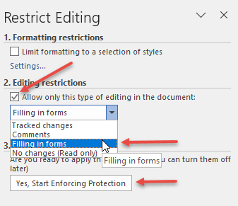

    Finally, when all the fields and other text are complete and correct, click the Restrict Editing button on the Developer ribbon (or its twin on the Review ribbon). In the pane that opens, check the box under Editing Restrictions, select "Filling in forms", and click the "Yes, Start Enforcing Protection" button. You'll be prompted to enter a password (twice!) if you want one, but you can leave it blank.
    Until you start protection, none of the form fields will operate -- trying to enter text in one will just overwrite the field and delete it.
    If you want to make changes in the document, open the pane and click the Stop Protection button. You can go back and forth as many times as necessary.
