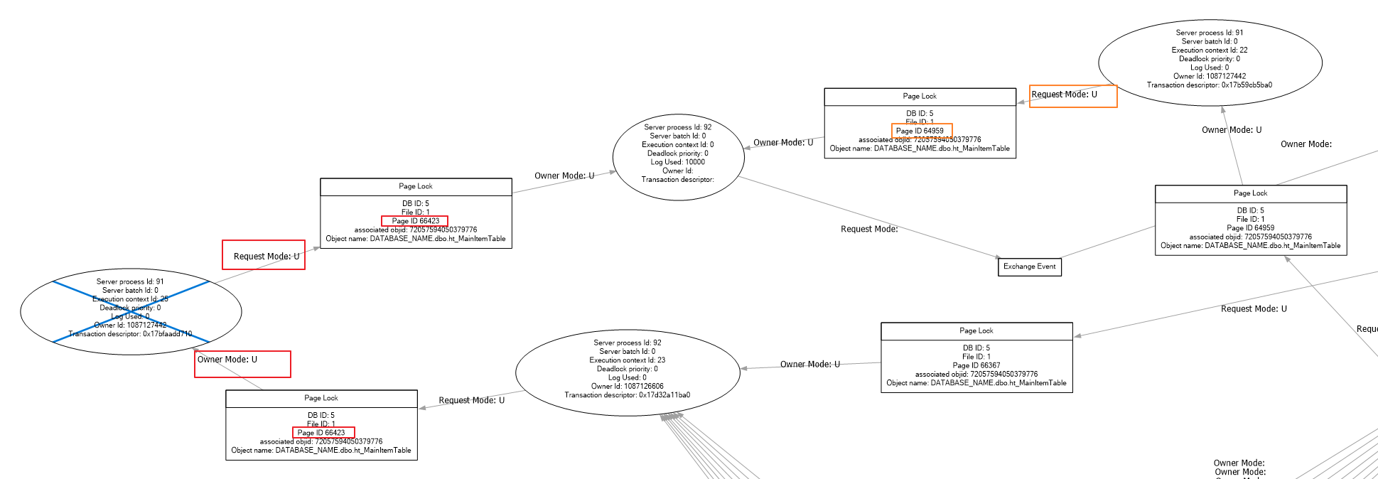

I have started getting deadlocks in one of my batch processed and have difficulties figuring out how to resolve it.
Deadlock graph and table structure is attached to the post.
For a start I dont understand why a pocess can have an active lock on a page and at the same time request what seems like an additional lock on the same page which cannot be granted.
I would be gratefull if anyone could point me in a direction :)

    I did not analyse that deadlock in detail. It looks quite complicated, as it both includes parallelism and locks.
    What I found is that there are two processes involved, spids 91 and 92. I see that both of them are Agent jobs step. One of them runs
    EXEC dbo.[Out_04.01.ItemLocation2] @db = N'webfi'
    The other process has webes instead of webfi.
    The obvious question is: why are there two jobs, and not one to run both things? (Maybe there is an equally obvious answer, but not knowing you system, it is not obvious to me.)
