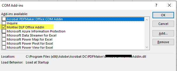

The only issue with the above steps was that one Add-in 'McAfee DLP Office Addin' even after disabling would re enable itself when I restart the application.
Apart from this I disabled all the other Add-ins but couldn't get my beloved insert option back.

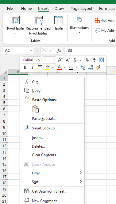

    It seems you are able to insert Row/Column via Home Ribbon tab and using the shortcut key. The issue only occur when you right-click on cell. Based on my test in same Excel version( as like yours) I can insert via right-click on cell, see image below for your reference:
    ![Image](https://learn-attachment.microsoft.com/api/attachments/a7c089e2-1301-4bec-a5cd-af39b75b13e7?platform=QnA"https://support.microsoft.com/en-us/help/929135/how-to-perform-a-clean-boot-in-windows" rel="ugc nofollow">perform a clean boot in Windowsto determine whether a background program is interfering with Office program.

    As you mention, “ The only issue with the above steps was that one Add-in 'McAfee DLP Office Addin' even after disabling would re enable itself”  the Inactivating an add-in does not remove the add-in from your computer. Try to remove the add-in from your computer, you can temporarily uninstall it and check the outcomes. It will help for us to narrow down your issue to check whether this issue cause by this add-ins.

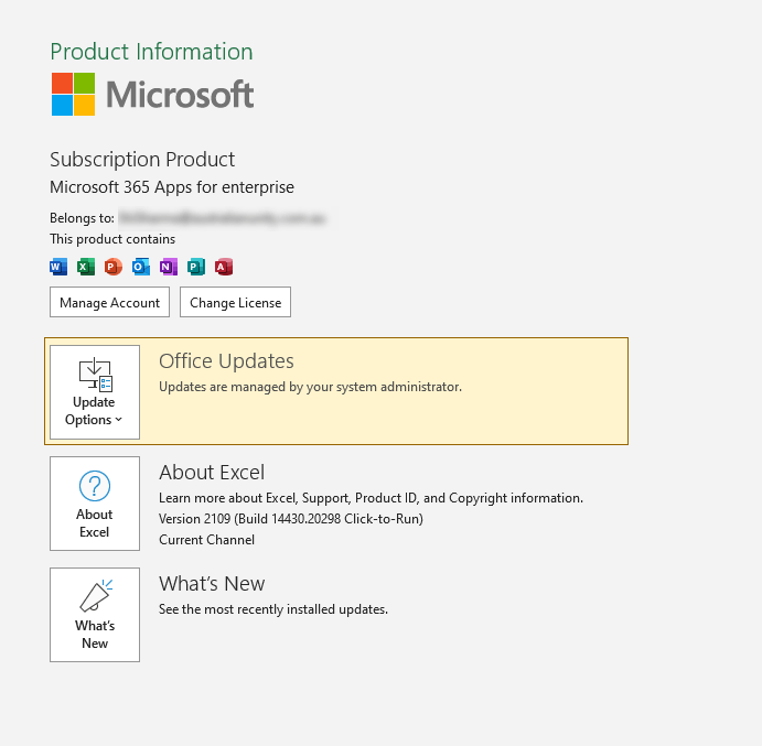

    In the meantime, to confirm whether this is a bug in a specific version, please provide us the version information. To check version: Open Excel>File>Account>Product Information and capture a full screenshot and share here (Please mask your private message for protecting your private message) and we will be tested on that version and verify the result with you.

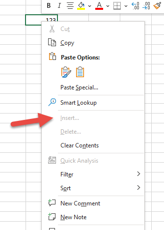

    Also, if you don’t mind could you please upload a screenshot of “the insert Row/Column Option is been shown as disabled” for our reference.

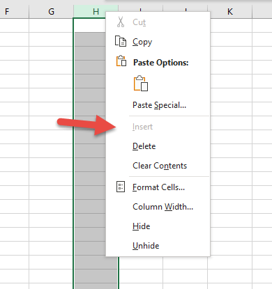

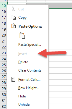

    However, I am not able to insert by right clicking a row/column/Cell and choosing insert. I have attached the screenshot for your reference:
    As requested please find the below screenshot:
