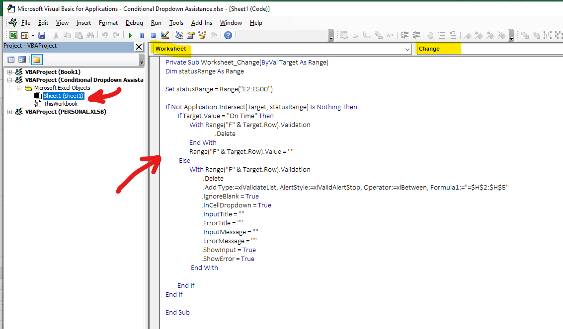

    Hi there
    AFAIK, We can not type a Formula and apply a dropdown Data Validation rule in a cell at the same time
    To help you with your request/scenario we might need to use VBA macro for the Worksheet event to achieve that
    1. Save your workbook as an Excel Macro-Enabled Workbook (* .xlsm)
    2. Paste the code below on the Worksheet event VBA panel as indicated in the pictures down below
    Private Sub Worksheet_Change(ByVal Target As Range)
    Dim statusRange As Range
    Set statusRange = Range("E2:E500")
    If Not Application.Intersect(Target, statusRange) Is Nothing Then
        If Target.Value = "On Time" Then
                With Range("F" & Target.Row).Validation
                                 .Delete
                End With
                Range("F" & Target.Row).Value = ""
         Else
                         .Delete
                         .Add Type:=xlValidateList, AlertStyle:=xlValidAlertStop, Operator:=xlBetween, Formula1:="=**$H$2:$H$5**"
                        .IgnoreBlank = True
                        .InCellDropdown = True
                        .InputTitle = ""
                        .ErrorTitle = ""
                        .InputMessage = ""
                        .ErrorMessage = ""
                        .ShowInput = True
                        .ShowError = True
                 End With
        End If
    End If
    End Sub
