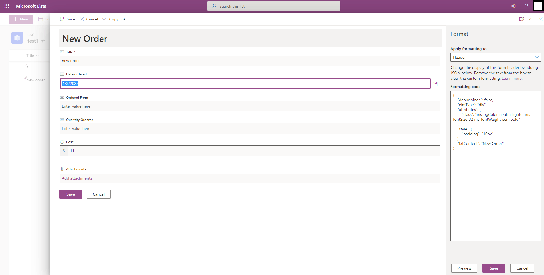

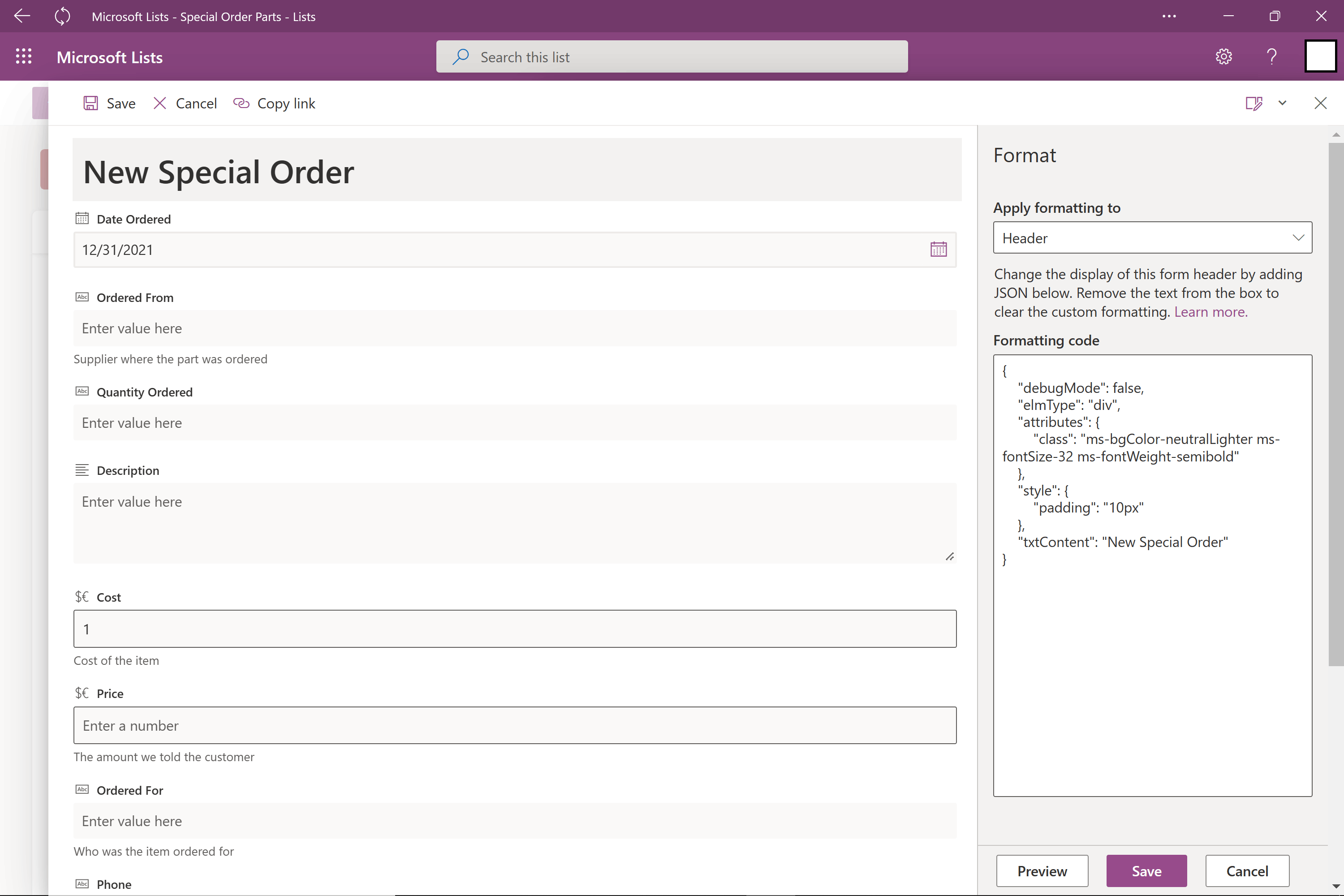

I'm trying to edit a form in Lists using JSON in the header. Here is the initial code:
"debugMode": false,
"elmType": "div",
"attributes": {
    "class": "ms-bgColor-neutralLighter ms-fontSize-32 ms-fontWeight-semibold"
"style": {
    "padding": "10px"
"txtContent": "New Special Order"
The above code works fine but if I change anything - example change "txtContent": "New Special Order" to "txtContent": "New Order", the code is not saved. If I press preview, it looks right. I then press "Save" and close the form. The next time I open the form, the original code is back.

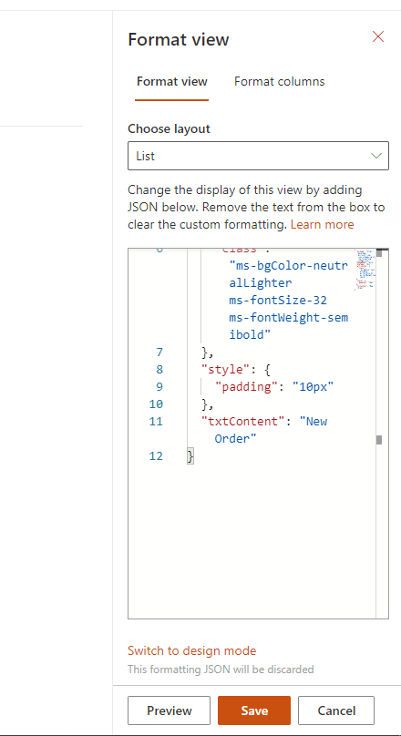

     As per your screenshot you are using Microsoft List app and when you add new item in Microsoft List the JSON code change to back original under "Header" layout section and when you code into "Body" section it also not save. May I know if my understand is correct?
    I just did a test and it seem I have on issue as like you described above. Here are my image for your reference:

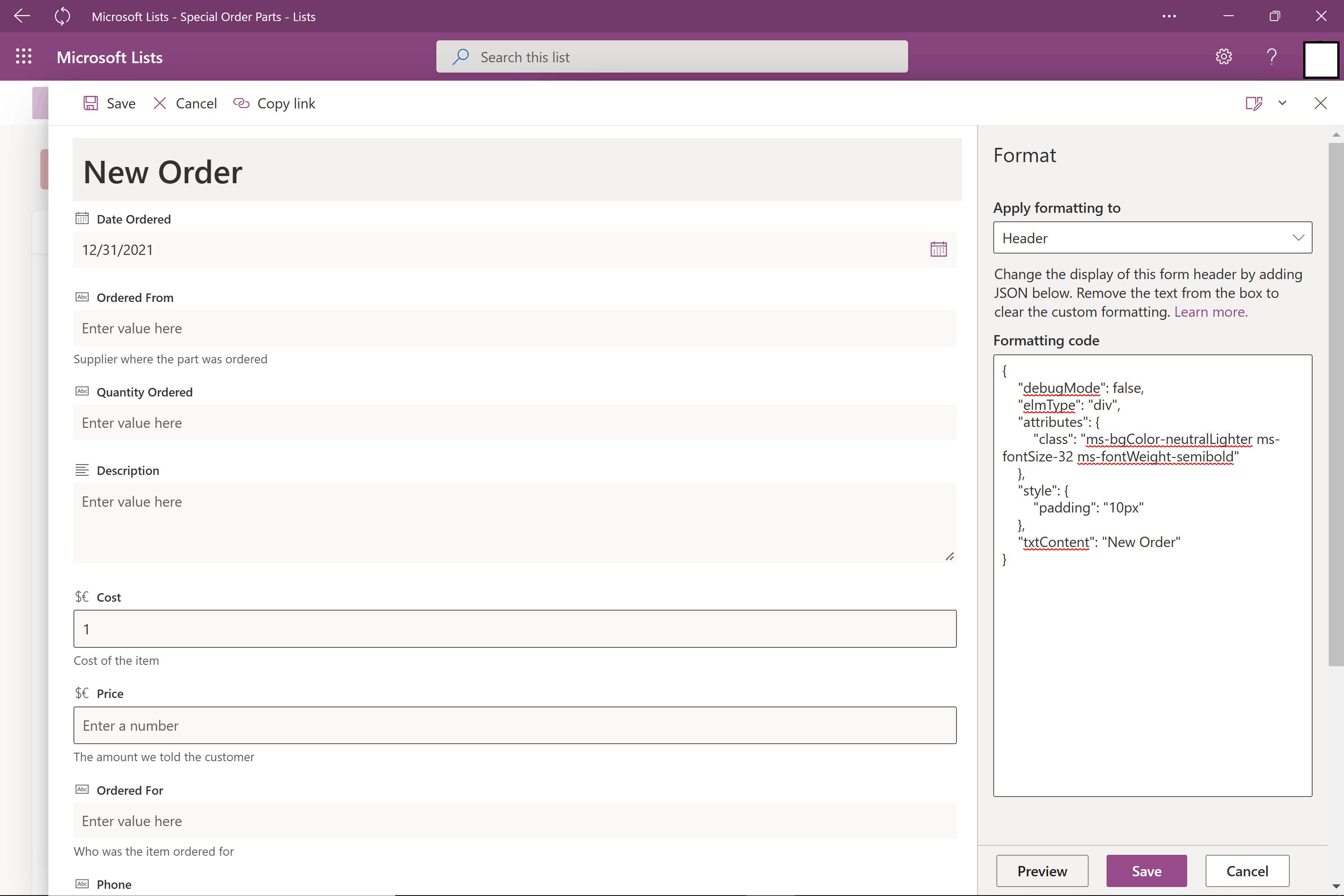

    I'm using the Microsoft Lists desktop application. I tried the code again on another list form and it is not working there either. When I press "Preview", it appears to work. I then press "Save", then close the form with the "X" in the upper right corner. There is always another form behind that one that is not showing the correct code so I "X" it out also. Also, the same thing happens if I paste code into the "Body" section (Different code but it doesn't save it. Preview works, but the code is not saved)
