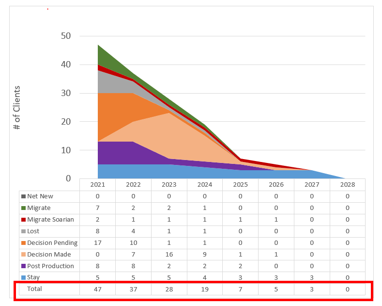

In my Stacked Area chart, I want to include the Legend Keys with a total line in the table below the Stacked Area chart. But I do not want the total line to be part of the Stacked Area chart itself. I found an example of one that displays what I would like it to look like and I attached it. The Total line at the bottom I outlined in red. You see it totals the table, but is not included in the Stacked Are chart itself.

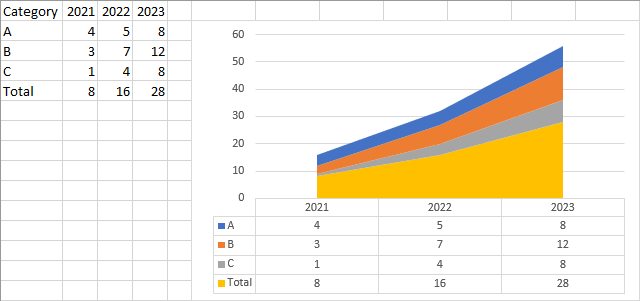

    Step 1: create a chart including the totals:

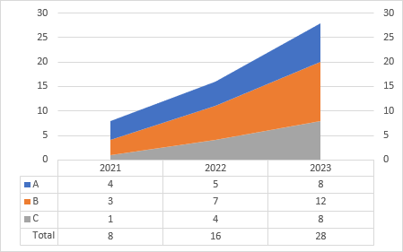

    Step 2: select the Total series.
    On the Format tab of the ribbon, under Chart Tools, click 'Format Selection'.
    a) Under Series Options, plot the series on the Secondary Axis:
    b) Under Fill & line, set the series to use No Fill and No Line:
    The Total series is now completely invisible, but still shown in the Data Table:
