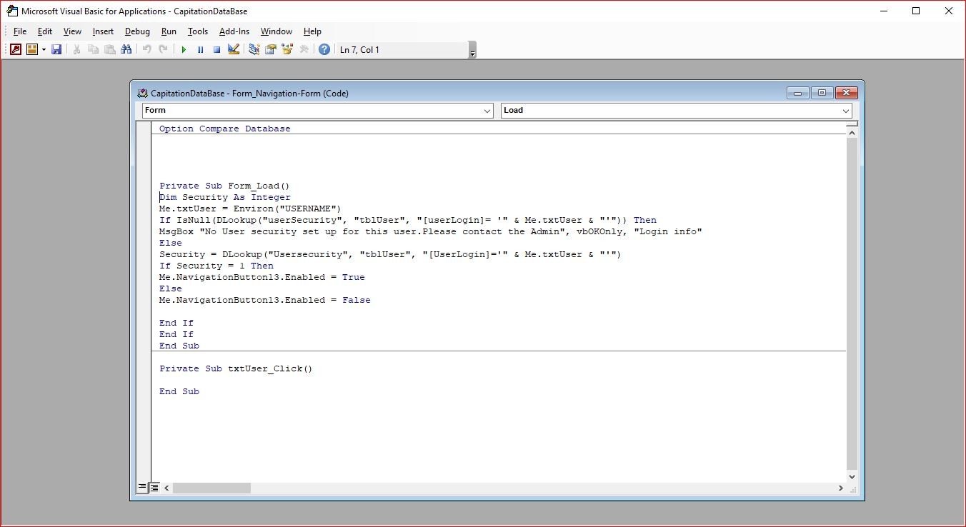

Initially I created a login Form using macro in Microsoft Access but decided to use vba code instead.
I deleted the macro form but now after creating a new login Form,it autofills the login details with an old username.
This prompts an alert that the user is not authorized to log in.
Even after I clear it and key in valid credentials I can't log in.
How do I remove this autofill?
Kindly assist as I have tried everything in vain.

    Thanks a lot for your quick response.Yes I created the other login Form from scratch.
    During the creation of the first form,at one time there was a related query that I had created that popped up as I saved.Being a learner I went ahead with it.
    I have attached the screenshots of the code and the password auto fill.I appreciate any assistance accorded.And thanks for your help.ImageImage
    If that's all the code you have on that form, you won't be able to log in, unless you update the user table with the "old" username, because that code only fires once - when the form opens.
    If you want the user to type in their username to log in, you can either use the AfterUpdate event of the Textbox or provide a button to log in. Also, if you don't want to autofill the username, then delete the line:
    Me.txtUser=Environ("Username")

    Did you create a new form from scratch? We'll need to know exactly what you did to be able to say what may be wrong with it.
