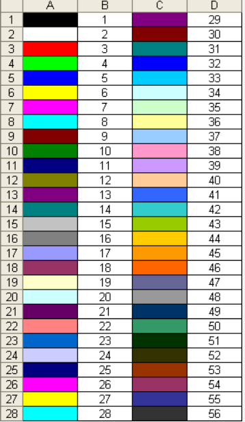

    Since I don't know your entire formula, I just wrote one simple formula as an example, replace it with your actual formula on every Format Condition in the code, I also used the same colour just, for example, you can use different a color index based on your requirement, to see the list of numeric values of the colour index, check the screenshot and replace the numeric value in the code:

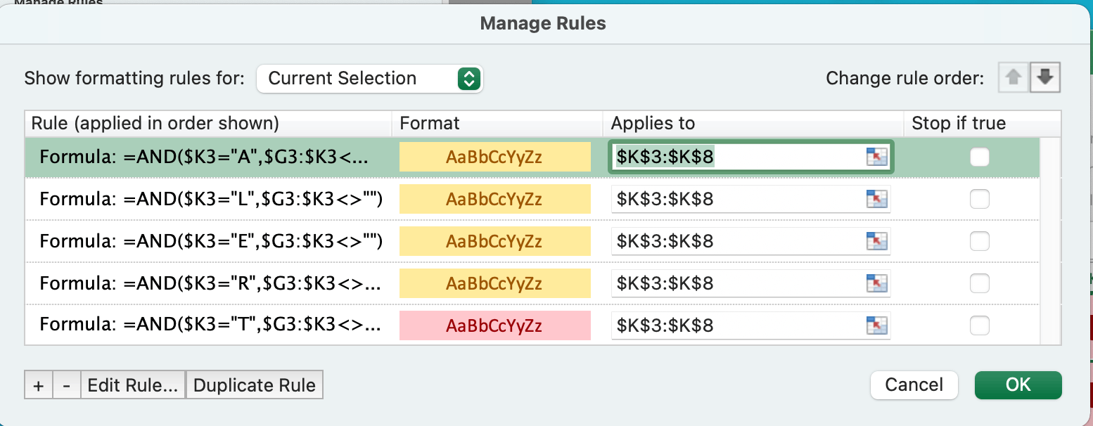

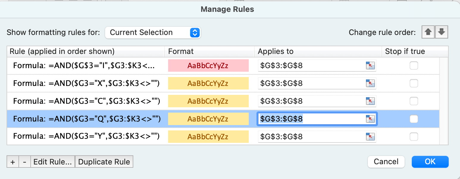

    2022-02-27T06:19:03+00:00
    This is from the conditional formatting box with its my rules. The same letters appear from g3:g8
    and are repeated h3:h8 to k3:k8 just different formatting. I was looking to be able to replace the letters I X C Q Y....with another set of letters, could be V D T C A
