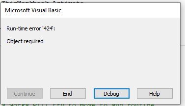

Run-time error 424: Object Tequired

When I do this I get the following Error message at the line:
   "If Target.Address = SymChange.Address Then"
Any suggestions?

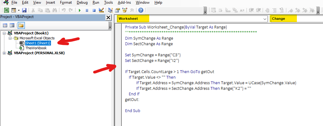

    2022-02-19T12:29:32+00:00
    Hi GibRoberts
    The problem is the object variables are spelled differently in the code (highlighted in the picture below)
    You may use this single code for the Change Event and replicate it to all the other sheets
    No need to create a module and use the Call method to implement it.
    Private Sub Worksheet_Change(ByVal Target As Range)
    Dim SymChange As Range
    Dim SectChange As Range
    Set SymChange = Range("C3")
    Set SectChange = Range("I2")
    If Target.Cells.CountLarge > 1 Then GoTo getOut
    If Target.Value &lt;&gt; "" Then
            If Target.Address = SymChange.Address Then Target.Value = UCase(SymChange.Value)
            If Target.Address = SectChange.Address Then Range("K2") = ""
    End If
    getOut:
    End Sub
