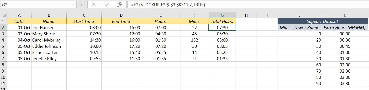

    Please check whether the following solution is helpful:
    To calculate Total Hours, formula in cell G2 will be: =E2+VLOOKUP(F2,$J$3:$K$11,2,TRUE)
    To only calculate the extra hours, the formula in cell G2 will be:
    =VLOOKUP(F2,$J$3:$K$11,2,TRUE)
    Note
    1) In the above formula, please change cell references/ranges to suit Your requirement.
    2) Please drag the formula down to as many rows as required.
    Please respond if You require further support. I will try My Best to be of help.
    If I was able to help You, please mark My response as "answer" and "helpful".
    Thank You!
