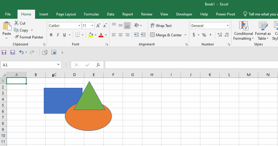

    Why is there a need for a macro? When I select a shape inside a group I can change the color using the UI:
    And if you record a macro during the color change you get a macro like this:

    And to answer your question about the names, when a shape inside a group is selected you can get the names this way:
    Sub Macro2()
    MsgBox _
    "Shape : " & Selection.Name & vbCrLf & _
    "Parent: " & Selection.ShapeRange.ParentGroup.Name
    End Sub
