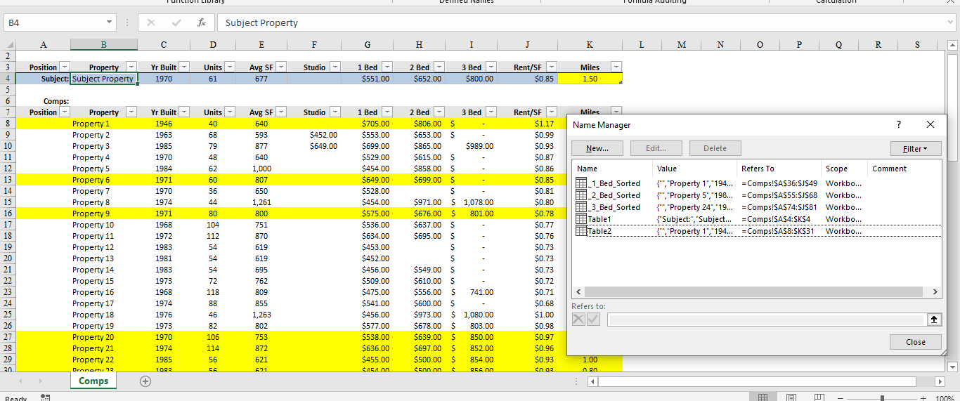

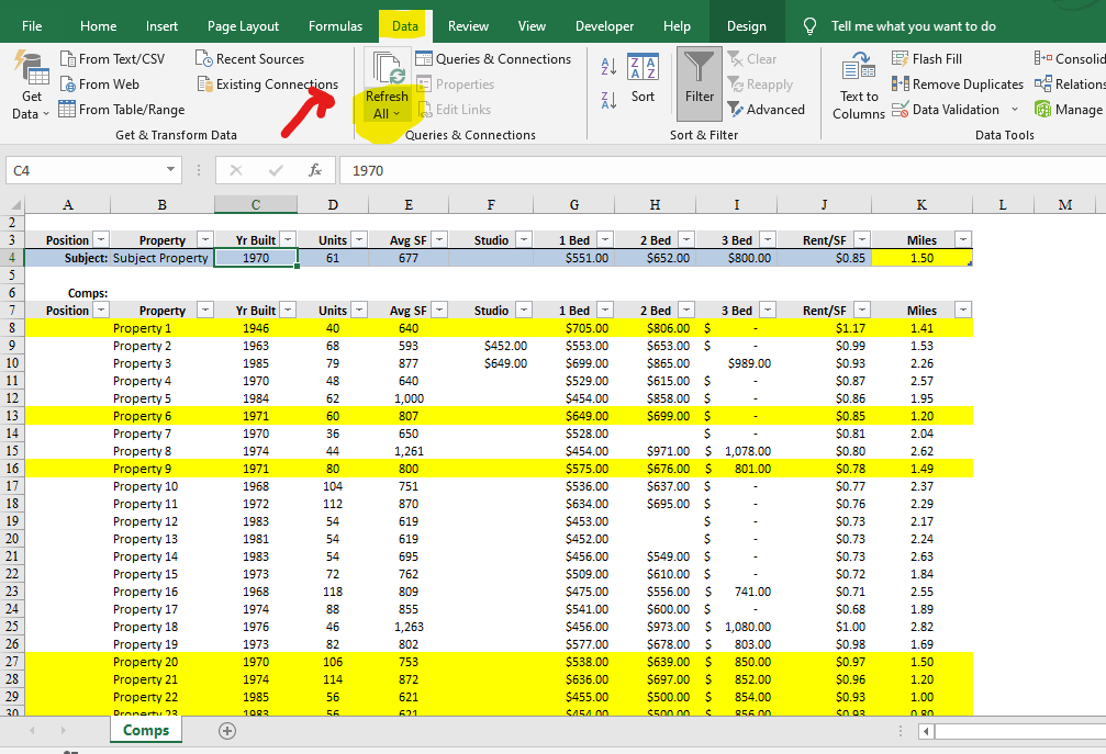

    The picture below shows the new template scenario
    I also added a conditional formatting rule to highlight rows (Yellow) in the Comp table that match the threshold conditions (i.e. <=Threshold eg <=1.5 miles)
    You need to enter the Miles threshold in cell K4 (in Yellow).
    And go to the Data ribbon tab and refresh the query
    RESULTS
    In my next reply, I will give more details about the query process.
    Now I'm very busy and I have a meeting to attend.
    Play with the file and let me know how it works, about the Year thresholds, and any other doubts.

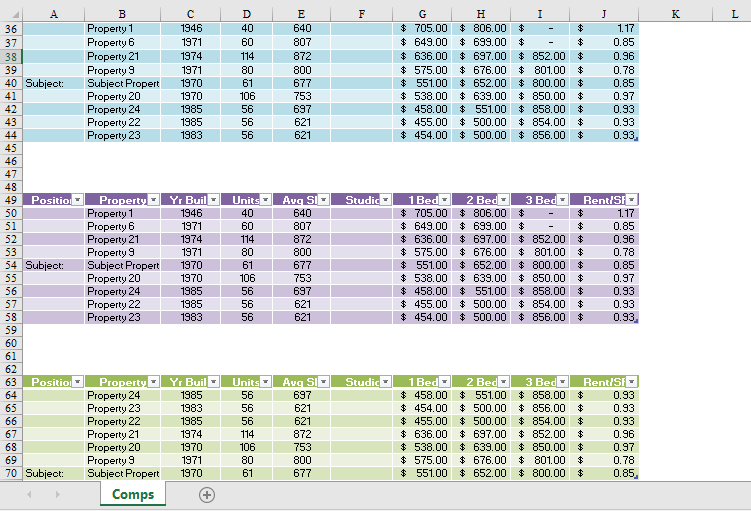

    Good morning, Jeovany. Thank you! Pardon the confusion I may have created. There wouldn't be any hiding of columns, only the hiding of the unused rows in the break-out/sort sections (where the comps plus the subject property are sorted from high to low in red font) as well as the break-out/sort sections themselves for each unused bedroom type.
    Would the Worksheet_Change Event just be for hiding the unused break-out/sort sections (since the subject property's rents are entered manually) while Worksheet_Calculate for the unused rows within those break-out/sort sections since those are generated from formulas?

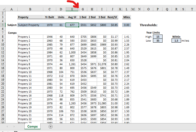

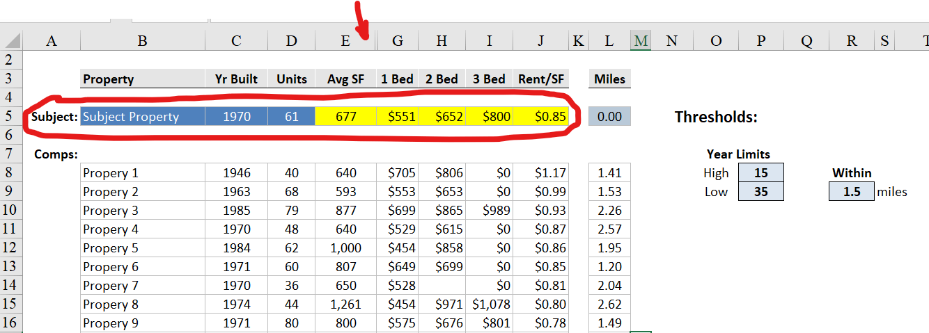

    In the picture below from your sample file, the "Studio" column yields a "Blank" value from the formulas in it
    If I understood correctly you would like to hide that "Unused column". If we do so It would affect the Comps table and the Subject data entry table at the top of the template.
    Let's assume the macro hides the unused rows and columns automatically as your requirement
    How could we unhide back the columns?
    As I see it
    We would need to create 2 sets of data entry processes/orders for the ranges B5:D5 and E5:J5
