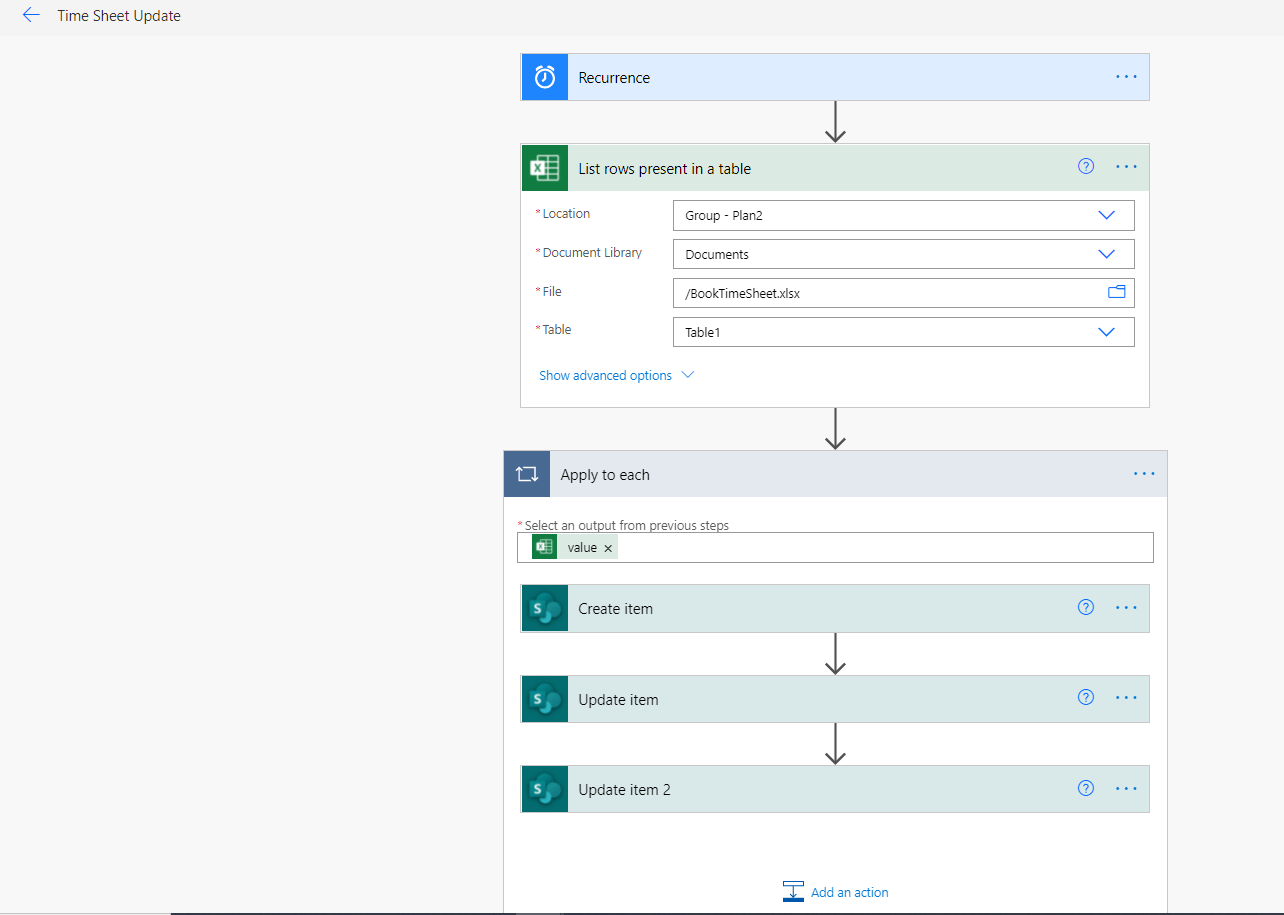

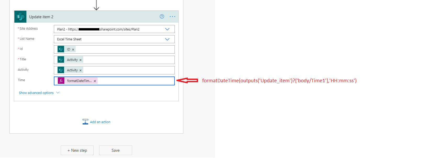

    As you mentioned, "The problem is when it is transferred to Sharepoint the time is converted to integers. (original data entry table below prior to moving to Sharepoint)." when we trying to import an Excel data Table (the table includes a time Column.) to SharePoint List. The Flow can't import such Excel time column into SharePoint List directly. You need to format time in Flow like in below screenshot. Please refer to below Flow.
    Flow:
    ![Image](https://learn-attachment.microsoft.com/api/attachments/d0c8263c-f477-4aeb-9add-0c6b2a0f024e?platform=QnA"https://learn-attachment.microsoft.com/api/attachments/0623e357-892f-49b9-b700-f3cc04d2e6e5?platform=QnA" rel="ugc nofollow">Image
    Result:

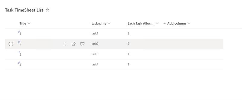

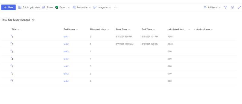

    As you mentioned, “I am unsure how to make a timesheet using lists as you can't seem to enter times and then I am unsure how I would be able to calculate hours worked”I assume if you enter data information in one SharePoint online list 1 for example list1 with two columns (task and task completed hours column). In another SharePoint list you use LOOKUP column ((information already on this site) to populate task and hours. See image below for data inform list.
    LOOKUP column in another list.
    Regarding to “ I need to be able to multiply the amount of items processed by the time allocated to that task to work out a total core time with which to calculate the productivity.” as I’m not sure but I assume does it mean if multiple user complete same task and you want to calculate total hours? e.g. three users complete same task(TastB) and calculate the total hours of TastB. If I’m misunderstood your scenario, please feel free to correct me and I will try by best to find a way for your requirement.

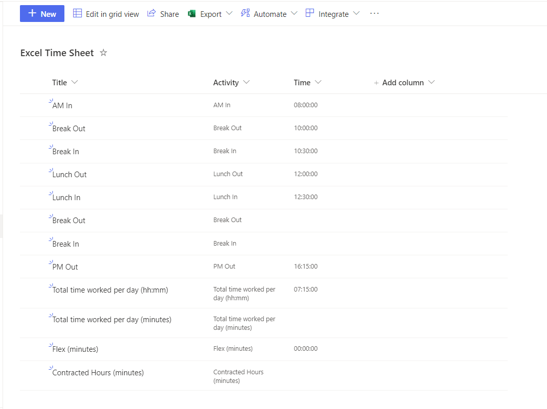

    I still need to figure out how to work the timesheet element and after reading a slew of threads I still don't see a clear way to do this. The timesheet is below - the team members would fill out their times in 24 hour clock in and out. The total time worked per day is calculated from those times and the flex is calculated based on the time worked in minutes and shows the amount of time under or over the contracted hours. The problem is when it is transferred to Sharepoint the time is converted to integers. (original data entry table below prior to moving to Sharepoint).
    AM In 08:00:00
    Break Out 10:00:00
    Break In 10:30:00
    Lunch Out 12:00:00
    Lunch In 12:30:00
    Break Out
    Break In
    PM Out 16:15:00
    Total time worked per day (hh:mm) 07:15:00
    Total time worked per day (minutes) 435
    Flex (minutes) 15
    Contracted Hours (minutes) 420
