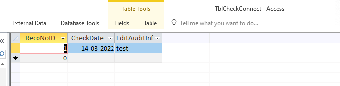

Trying to test the code to add record and delete it. So added one test record manually and running the code for the further.
No records get added neither it deletes the records.
Could not understand what it error in the code, please check and guide

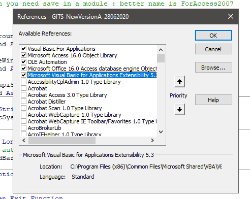

My Reference selection is below (I am pasting, generally this selection also creates issue)
Please check and advise the correction.

    Why do you have the extensibility reference library?

    E.
    "Why do you have the extensibility reference library?"
    No idea why I selected it, while testing a xls import file, I was having trouble and while searching I found in some of the website to be selected.
    Is there any website, which you can guide me to learn more about these references.
    I means some of the important reference, I must selected for the application to run smooth, which should include the excel import etc.
    Thanking you once again and will be looking forward to your advise/links.
