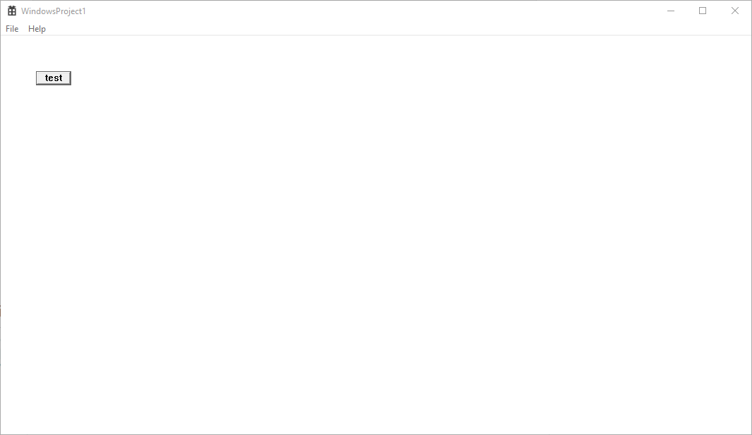

  2. Sam of Simple Samples 5,571 Reputation points
    2021-08-13T20:25:52.103+00:00
    Using Visual Studio I created a new Windows Desktop Project with Application type of Desktop Application. I added the #define for BUTTON_ID. Then in the switch statement in the WndProc I added:
    case WM_CREATE:
    HWND button = CreateWindow(L"BUTTON", L"test", WS_CHILD | WS_VISIBLE | BS_DEFPUSHBUTTON, 50, 50, 50, 20, hWnd, (HMENU)BUTTON_ID, hInst, NULL);
    break;
    That works for me.
    The documentation is at Button. Also see How to Create a Button.
