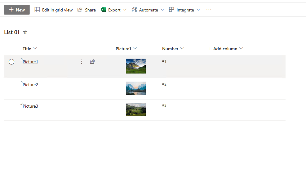

I am currently working on a list in SharePoint to organize pictures. I would like the Item # to automatically increase by 1 whenever a new line is added.

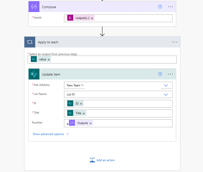

    Dear Darrien,
    You can use the flow (Power Automate) below to achieve your requirement.
    Uri:_api/web/lists/getbytitle('<list title>')/ItemCount
    Inputs: outputs('Send_an_HTTP_request_to_SharePoint')?['body']?['d']?['ItemCount']
    Best Regards,
    Cliff

  3. matt howell 3,501 Reputation points
    2021-11-10T16:25:06+00:00
    Flow seems like overkill for someone who stated they aren't technical, and since the ID field already accomplishes the same thing, why not use that much simpler option?
    And once again, it should be pointed out the response was marked as the answer by a Msft person, not the original poster:
    11/10/2021 12:40:04 AM Marked as answer Sukie Qi MSFT
    2021-11-11T15:49:01+00:00
    Thank you so much for clarifying and acknowledging the details of my post. My only problem with that automatic column is that it doesn't change if a row has been deleted. This could both be beneficial or cause a problem over time. I am very grateful for your response though and will truly think about the pros and cons of that column. I have a feeling it will be more helpful, easier and accomplishing than not.
