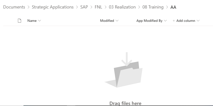

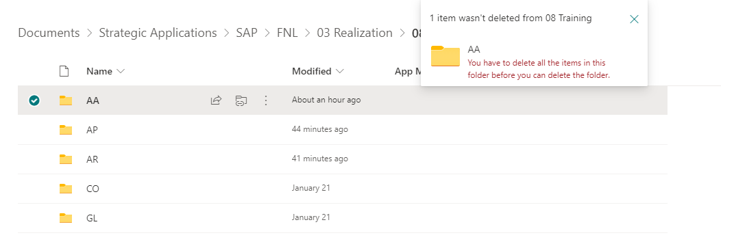

Unable to delete empty folder on Sharepoint
Error message
you have to delete all the items in this folder before you can delete the folder

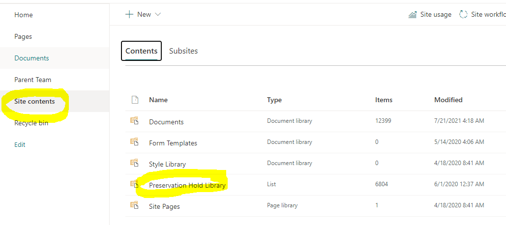

    Site Contents page > Preservation hold library
    2021-07-21T14:00:59+00:00
    Hi Ong Yong Siang,
    Thank you for sharing the screenshot. As you can find Preservation hold library in site contents page, that means a retention policy is applied to the SharePoint site.
    Here is an article for reference:
    Learn about retention for SharePoint and OneDrive
    In this situation, as I shared before, I suggest you contact your Microsoft 365 admin to turn off the retention policy. After that, check if you can delete the folder.
    Note: it may need some time to take effect after disabling the policy. You may need to wait some time and check the outcome.
    Feel free to let us know how it goes.
    Hope you have a nice day.
    Best Regards,
    Tina
