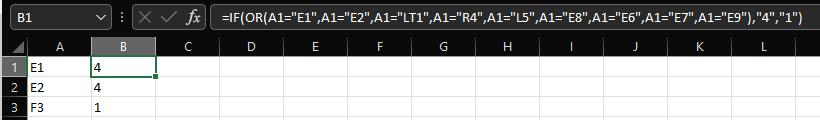

    The formula looks good to me, and it works on my side:
    In the list you provide, you have hidden space behind the value:
    In this case, the formula won't work, because "E1" does not equal to "E1 ".
    Meanwhile, if you are not sure which part of your formula is wrong, using the Evaluate Formula function will be helpful.
