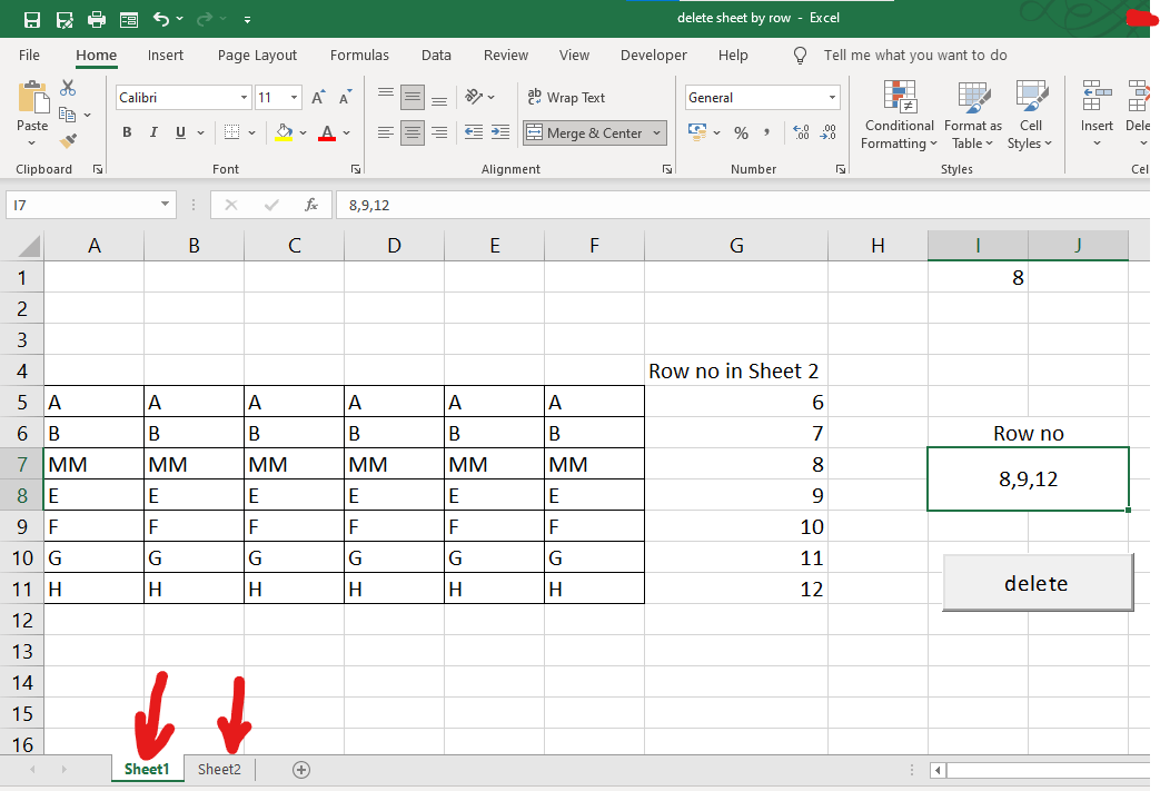

   two sheet namely entry sheet and Record sheet,  delete Entire Row in Record sheet using Row no in Entry sheet. row nos are  in  entry sheet at I7 cells, but that cells have comma separated row no,  whatever in I7 cells must delete Record sheet using  delete button in Entry sheet...
Given best solution in Vba, i am unble to found how to delete rows using comma separated rows no in excel other site...
i shared below file ... https://drive.google.com/file/d/1myg1E9i1zW-McEaJFh0PLz463HveGEZZ/view?usp=sharing

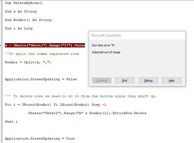

when execute code,, Error comes as run time Error "9", Subscript of out of Range
In the sample workbook, you gave us sheets are named Sheet1 and Sheet2 as shown in the picture below.
So if on the original workbook the sheets are named differently, you must adapt the code, and change the names of the sheets (highlighted in RED) accordingly.
So if Sheet1="Data Entry" and Sheet2="Records"

    2021-10-02T15:27:14+00:00
    Hello Arunsharma_955
    I expect the error message is due to the tab names in your workbook not being the same as the sample code.
    Please modify the code to Sheets("Sheet1") to read Sheets("thesheetname") and also lower down Sheets("Sheet2") please do the same change.
    I tried it both ways and when I changed the name sheets to Entry and Record without changing the VB code it generated the error above.
    The new code should look like this, depending on your sheet names.
