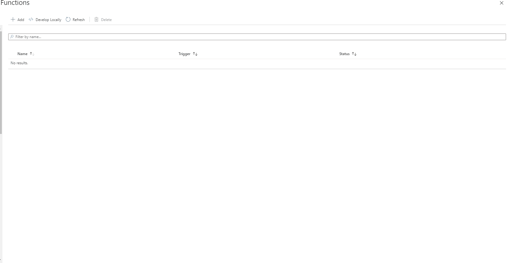

    Workaround can be to use Azure Functions with Blob Trigger enabled as shown below. Code can be added further into this function according to the requirement once file is read. Please check below useful links as well.
