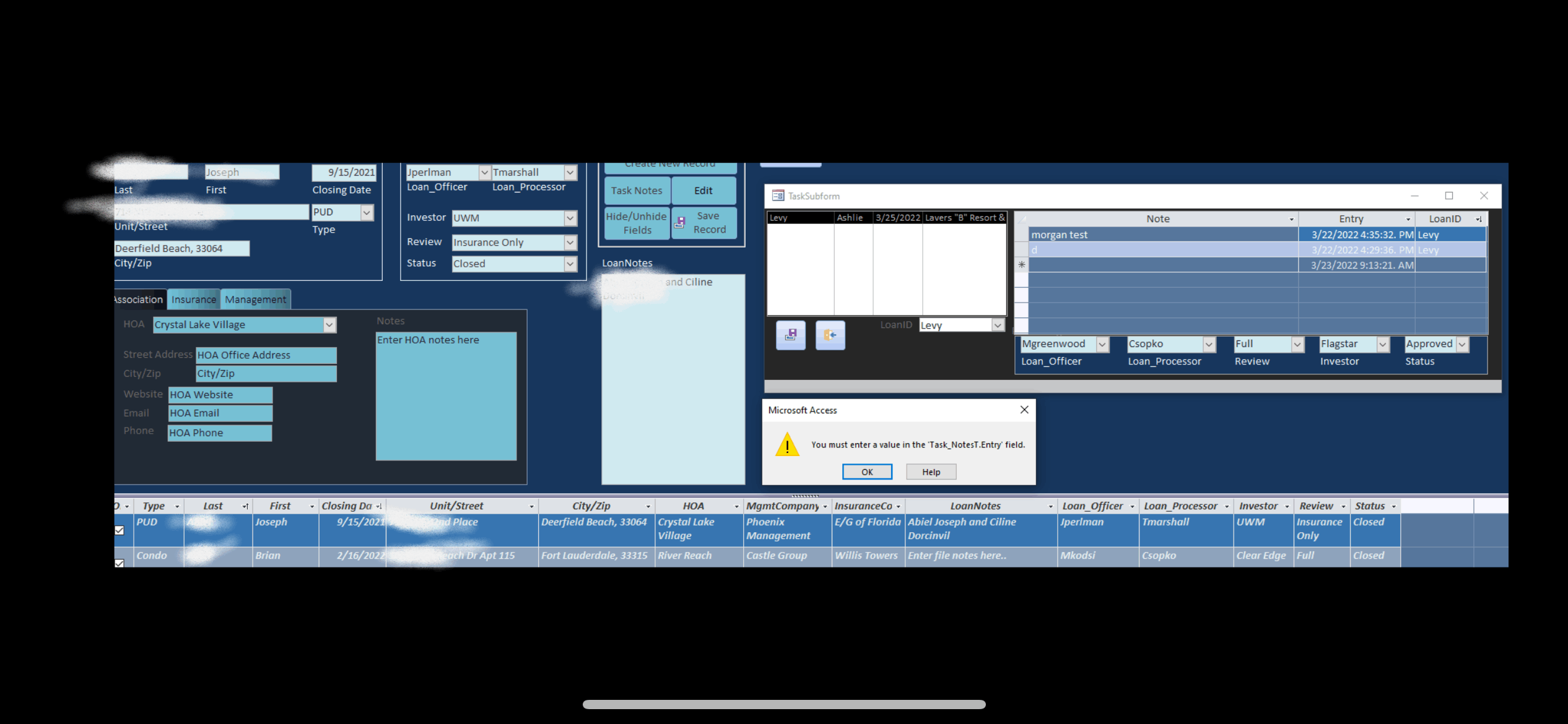

When I select a record in my database and hit the Task Notes button, it opens a subform TaskSubform showing the datasheet for the notes for that record. Here’s the situation:
The entry field defaults to value =now() for new records. If I add a note on the current record, it allows me to do that and it also allows me to click a list box option and also edit that one. however, if I open It and instead of making a note for the current record I first select one from the list box, then I get an error that I must enter a value for Task_NotesT.Entry field.
If I go to a record that does not have any notes yet, I can add a note but I also need to select the LoanID in the datasheet to complete the note (which is fine), however then in this case I CANT navigate to a new record without getting the same error.
I want to be able to open it from any record and be able to add notes to any record I select in the list box. Not sure how possible it is to make this happen without making it extremely complicated.

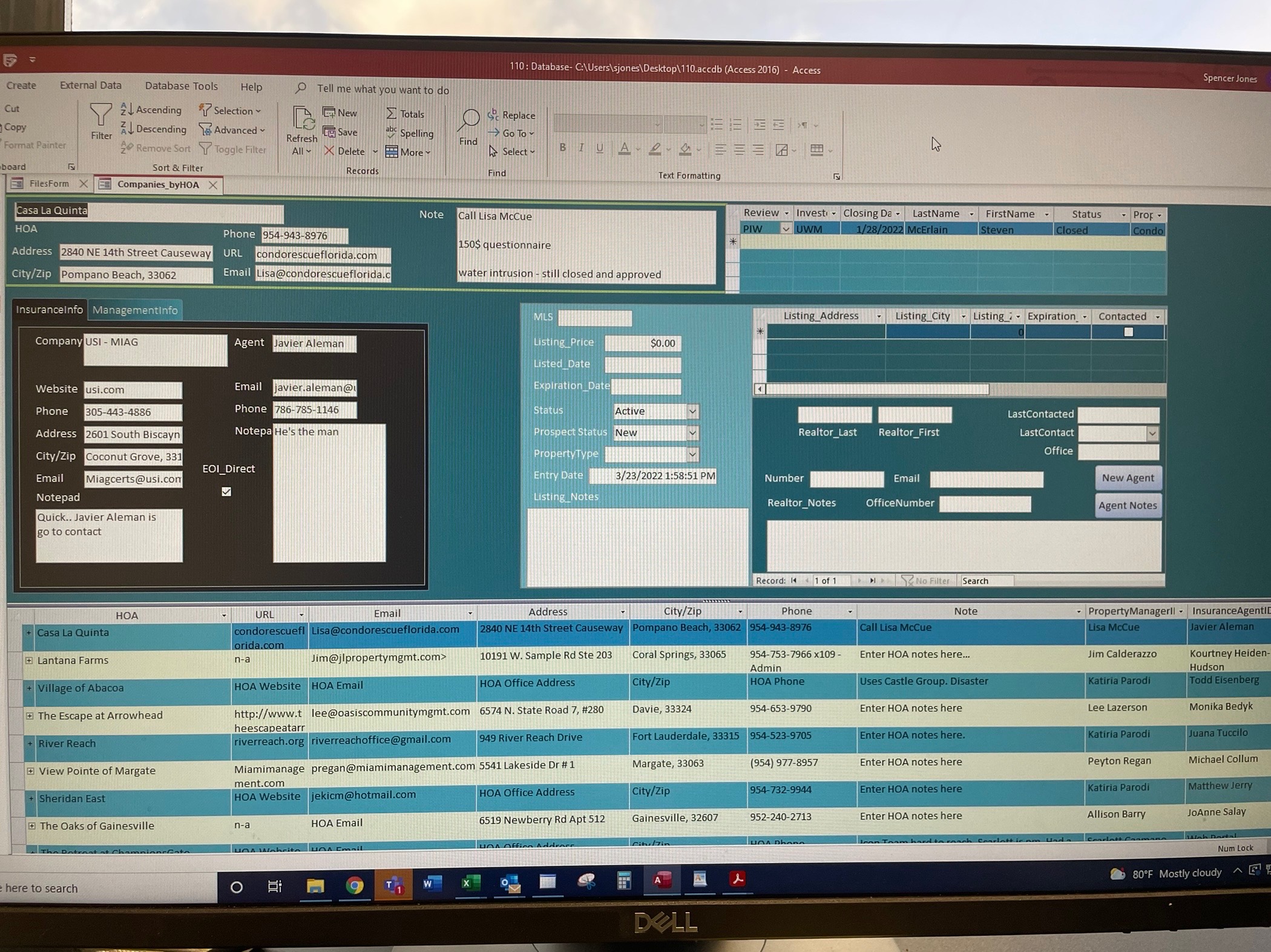

    2022-03-23T18:05:00+00:00
    This is a fantastic response. Thank you. I haven’t played around much with continuous forms but I think that actually would work better. I’m going to play around with it a bit and see if I have anything come up. But the logic around what you said for how to make it do what I want makes sense.
    I think it might be good enough the way it is, since main loan notes are on the main form and these are like sticky notes, however I agree it would be better as a continuous form for any changes I may want in the future. so I will do that.
    I think this will lead me to change more in the database. This leads into the grand purpose of why I’m doing this. I’m taking the approved associations and using the agents listing properties in that association as leads.
    I have another datasheet setup for the listings and additional information for property-listing and agent information as shown in the pic. I think I should also change this to a continuous form but thought while we are here I’d see if you had any comments.
    I’m not a tech guru and I’m going off what I learned in access in college so there could be better ways to do what I’m doing. Note the contact information here is public record and thought it’s safe not to omit
