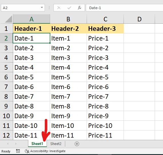

Let's say data in Sheet1 looks like this
Then try the following formula in the other sheets

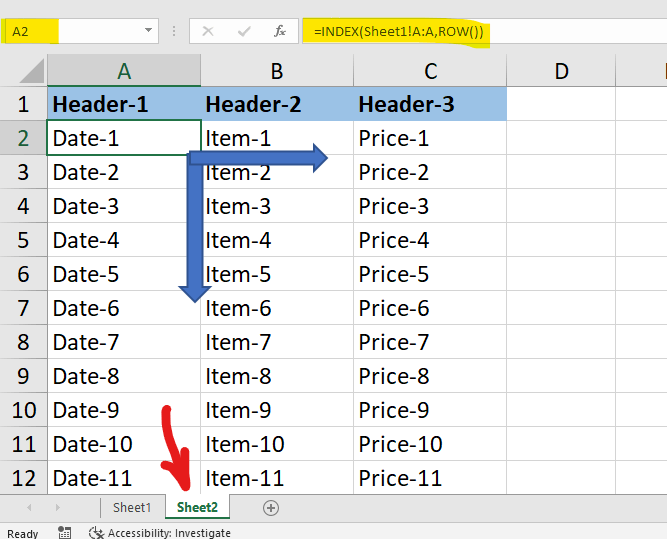

Cell A2=INDEX(Sheet1!A:A,ROW())
Adapt the ranges in the formula according to your real scenario
I hope this helps you and gives a solution to your problem
Do let me know if you need more help

    Thanks for your help!
    The Index function is a step in the right direction!
    I think the biggest issue I have is some headers are broken down within the data for project phases (with merged cells out of the 3 rows as a "break." I think the solution to that because it is different formatting is to just have rows ABC be one phase, DEF be another phase, etc. Trying to insert a row so it will insert into another sheet and keep formatting may prove to be more complex than anticipated.
