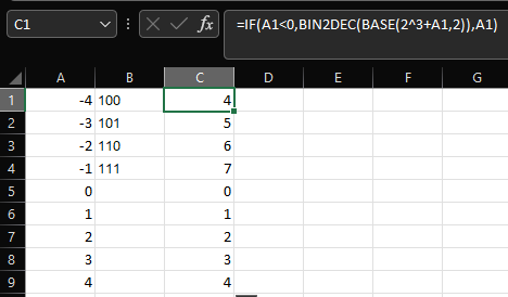

    2021-11-24T07:24:12+00:00
    Hi Alberto,
    I think the relation operator <0 is inevitable.
    Here is another thought on your requirement: Combine the following Excel inbuilt formula: Bin2Dec & Base
    =IF(A1<0,BIN2DEC(BASE(2^3+A1,2)),A1)
    Regards,
    Alex Chen
