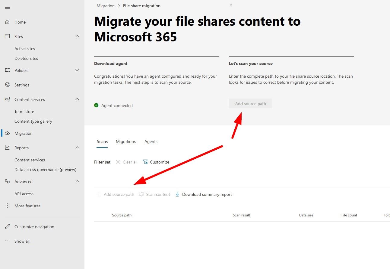

I recently discovered the migration manager and have successfully installed the agent then scanned my first source path.
After review the errors and deleting unneeded files, I noticed I could not rescan the paths to see if the migration warnings were gone. I deleted the original source paths and was going to re-add it.
Now I cannot add a source path at all (it is greyed out). I have tried with two different admin accounts.

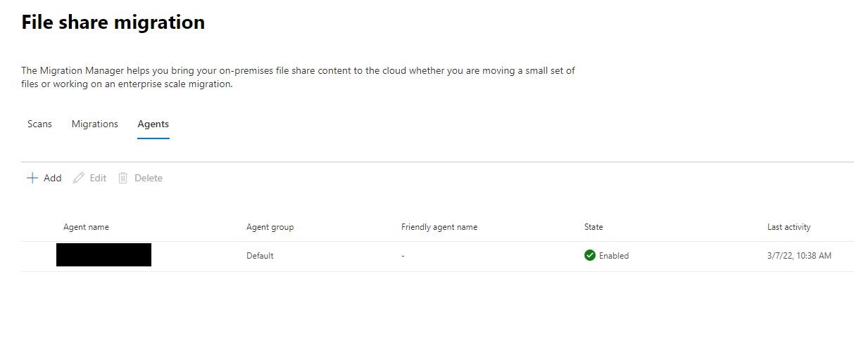

    According to your screenshot, I assume you have run agentsetup.exe, connected to tenant in Microsoft 365 Migration. You can view the agent under the Agents tab. Based on the reference and my test, after the agent is configured, please check if you can add source path to scan. If not, please create the task under the Migrations tab, then try to add source path to scan.

    Correct, I have configured the agent and it is enabled. Like I mentioned, I was able to add a source path last week and successfully scan it, but now I can't.

    Same thing happende to me. Event tried to delete all completed scans, to see if that could affect that. But no. Still - the "Add source path" is greyed out, even if the Agent is "enabled".
