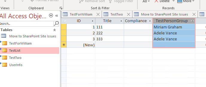

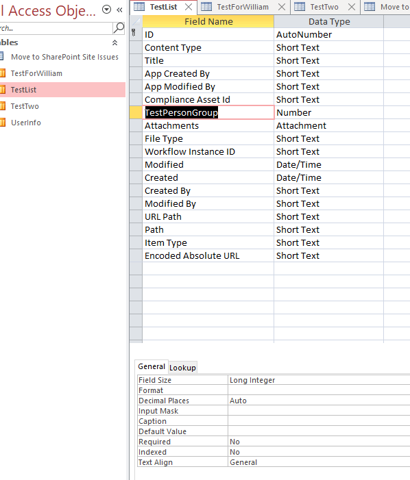

I have a Sharepoint list linked to an Access table. I need to query person/group fields in the first Sharepoint List in Access and append a second Sharepoint list with person/group values queried from the first list. Access shows the person/group field data types in the first Sharepoint list as numeric/long integer. But I cannot create a second linked Sharepoint list that will accept the appended person/group fields from Access. Access changes the Sharepoint data type so that the second Sharepoint list won't accept them - in either a number column or a person/group column.

    Besides, from my tests just now, the Person/Group field in the original list is numeric/long integer and it did become a number column when I tried to export it to a new SharePoint list.
