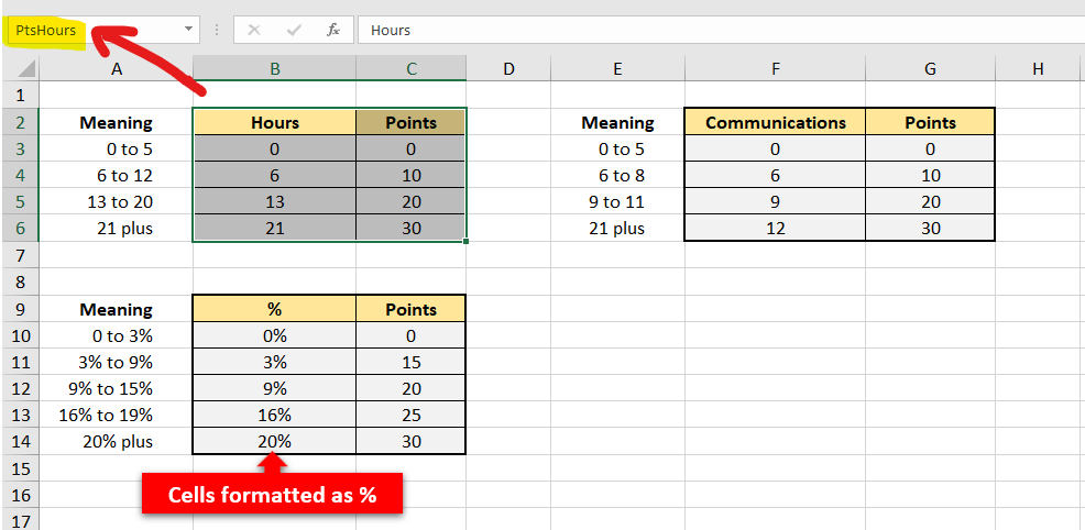

    1. On a new sheet (recommended) create 3 tables as in the picture below and give them a meaningful Named Range
    a) Points Per Hours Table aka "PtsHours"
    b) Points Per Percentage Table aka "PtsPercent"
    c) Points Per Communications Table aka "PtsComs"
    1. Assuming, for example, that cell X5 sums the hours of C5, E5, and G5
    Then to calculate the points try the formulas
    For Points Per Hours = VLOOKUP(X5,PtsHours,2,TRUE)
    For Points Per Percentage = VLOOKUP(X5,PtsPercent,2,TRUE)
    For Points Per Communications = VLOOKUP(X5,PtsComs,2,TRUE)
    I hope this helps you and gives a solution to your problem
