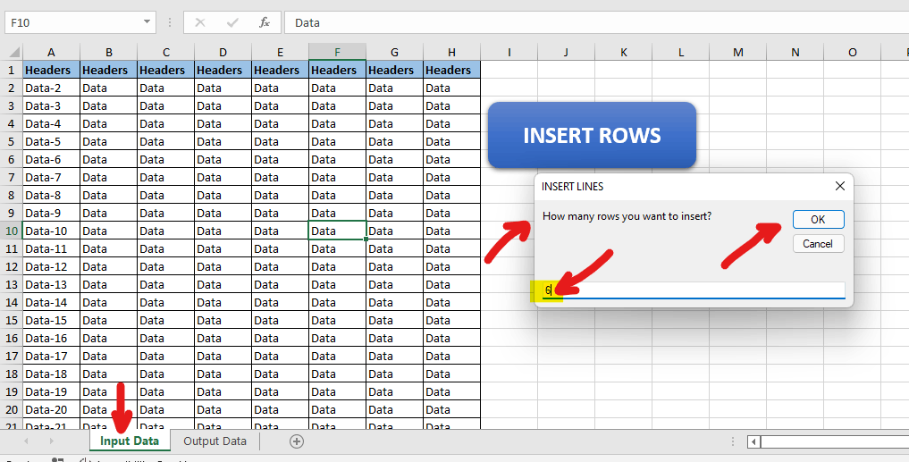

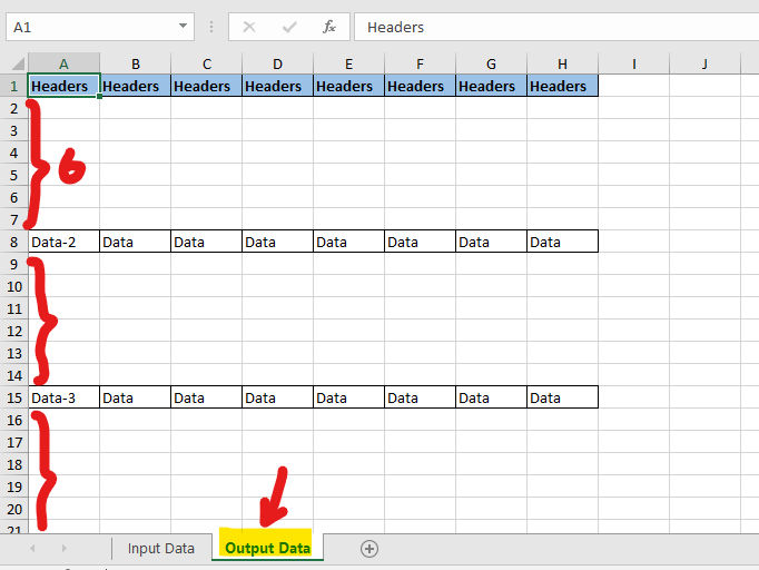

    2022-04-11T22:02:20+00:00
    Hi Maureen
    If you have to do the task multiple times then you need a VBA macro
    If so you may try the following code
    Sub InsertMultipleRows()
    Dim Lines As Long
    Dim lastRow As Long
    Dim inputSh As Worksheet
    Dim outputSh As Worksheet
    On Error GoTo getOut
    Lines = InputBox(Prompt:="How many rows you want to insert?", Title:="INSERT LINES")
    Set inputSh = ThisWorkbook.Sheets("Input Data")
    Set outputSh = ThisWorkbook.Sheets("Output Data")
    outputSh.Cells.Clear
    With inputSh
    lastRow = .Cells.Find("\*", SearchOrder:=xlByRows, SearchDirection:=xlPrevious).Row
        For x = 1 To lastRow
                .Cells(x, "A").EntireRow.Copy outputSh.Cells((Lines + 1) \* x - Lines, "A")
        Next x
    End With
    MsgBox "Job Done"
    getOut:
    End Sub
    This code will prompt an input box where you will enter the number of rows you want between each data line
    RESULT

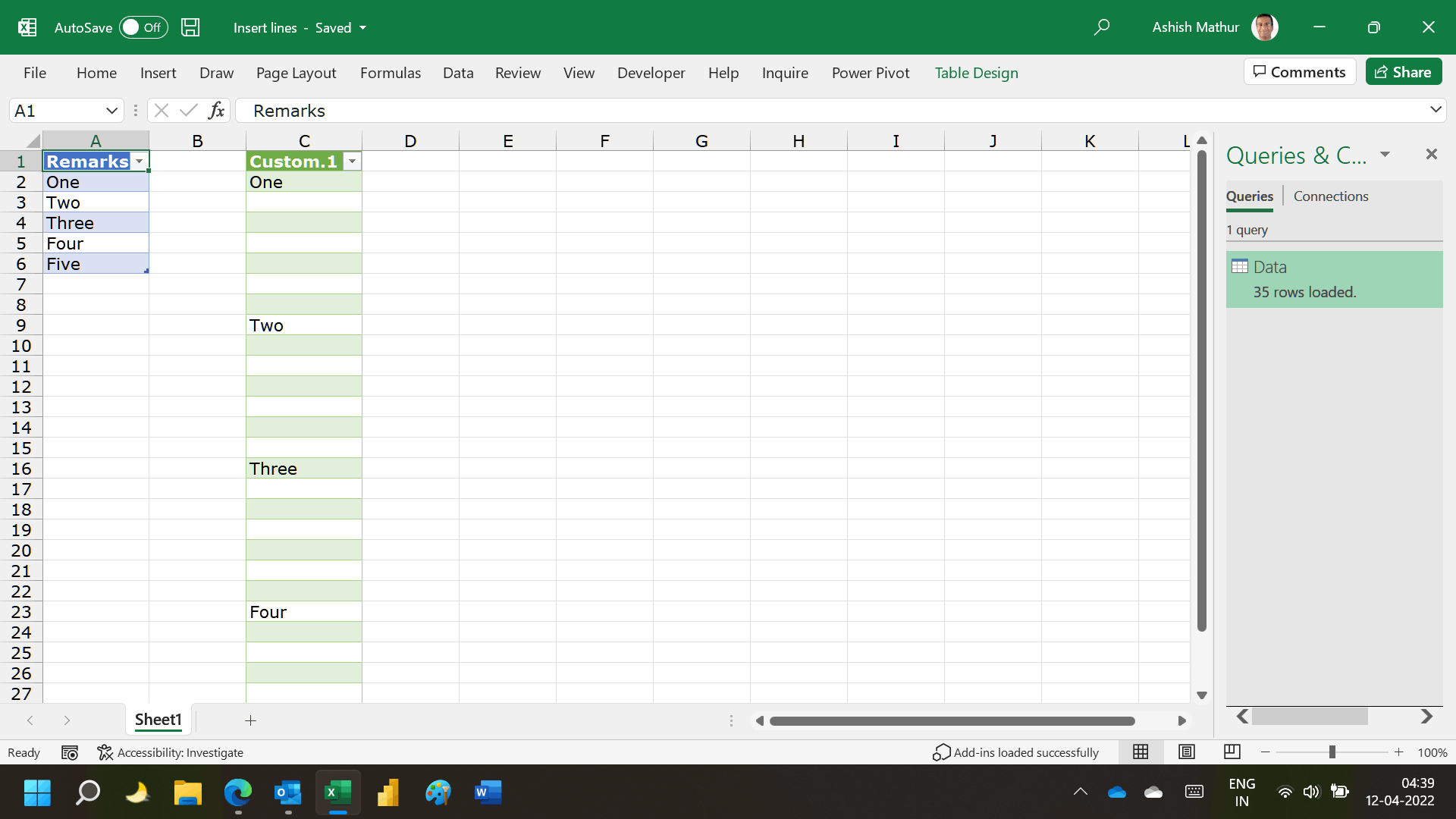

  3. Ashish Mathur 100.8K Reputation points Volunteer Moderator
    2022-04-11T23:11:31+00:00
    You may download my solution workbook from here. I have solved the problem using the Query Editor.
    Hope this helps.
