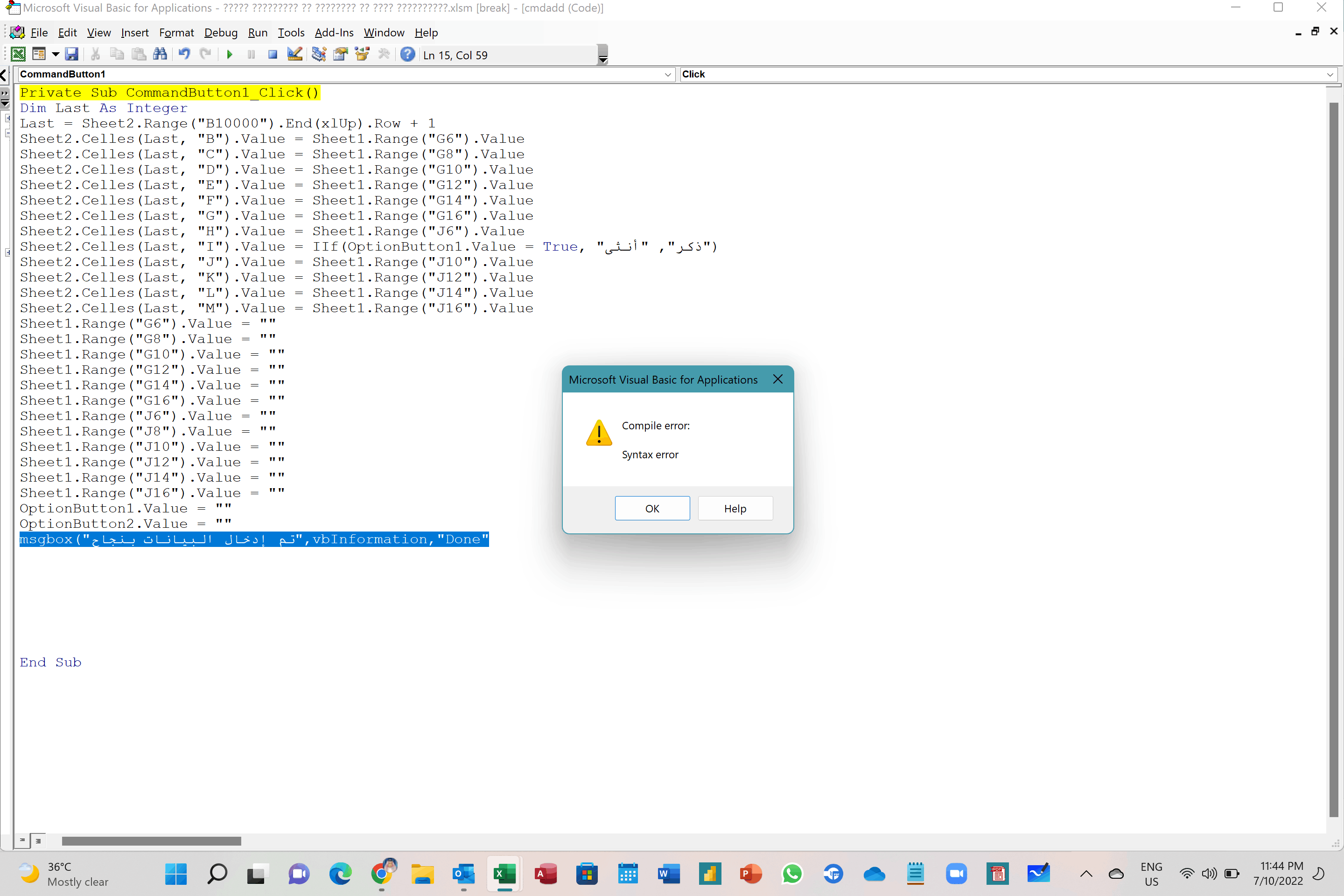

  1. Deleted
  2. Andreas Killer 144.1K Reputation points Volunteer Moderator
    2022-07-11T03:51:24+00:00
    The compiler selects the line with the error, the blue line. In there I can read
    msgbox("whatever",vbInformation,"Done"
    Means this is a different issue.
    I see an opening parenthesis, but the closing one is missing, hence the syntax error. Try
    msgbox "whatever",vbInformation,"Done"
    Please take a look into this tutorial for VBA beginners, IMHO it is helpful for you:
    Excel Visual Basic Tutorial - VBA Macros Online Training
    If there are more errors in your file it is easier if you share the file, so I can take a look.
    Share OneDrive files and folders - Office Support
    Andreas.
