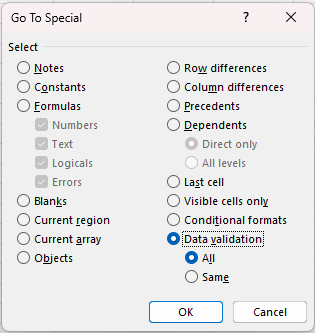

  3. riny 20,530 Reputation points Volunteer Moderator
    2022-10-23T07:23:50+00:00
    The easiest way to find and highlight all cells with Data Validation is to Press F5 and select Special... in the bottom left-hand corner.
    and then choose Data validation (All or Same), OK.
    Now format the selected cells with the color of your choice.
