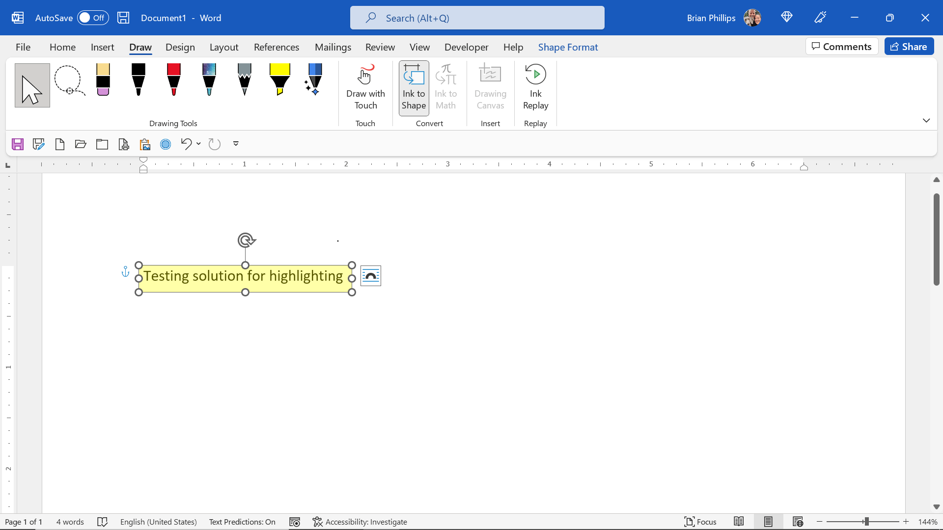

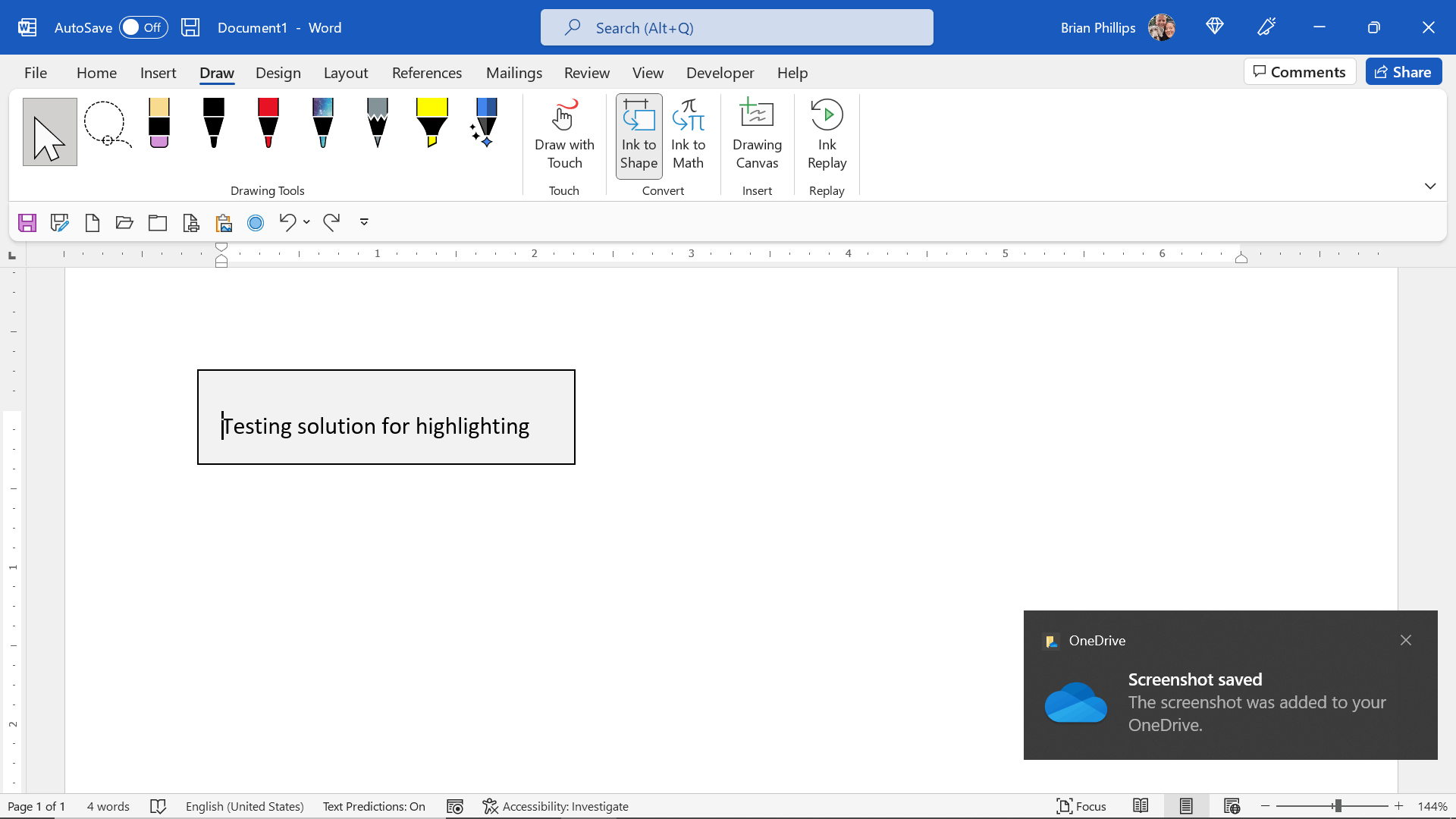

    2022-07-06T14:56:11+00:00
    After reading your reply, I realized I didn't specify what app I was having issues with. Your solution doesn't appear to work for MS Word, as the Draw tab in Word doesn't have an "insert shape" option.
    That said, your reply and the links you provided prompted me to try a work-around using the "ink to shape" tool.
    1. I drew a rectangle around my text, and it was converted to a perfect square-edged shape.
    2. Then I sized it to fit my text.
    3. Next, I right-clicked to get to the "format shape" option, and filled it with the color and transparency I desired.
    4. Finally, I removed the border.
    It's a little clunky, but it gives you an almost limitless amount of highlight color and transparency options.
