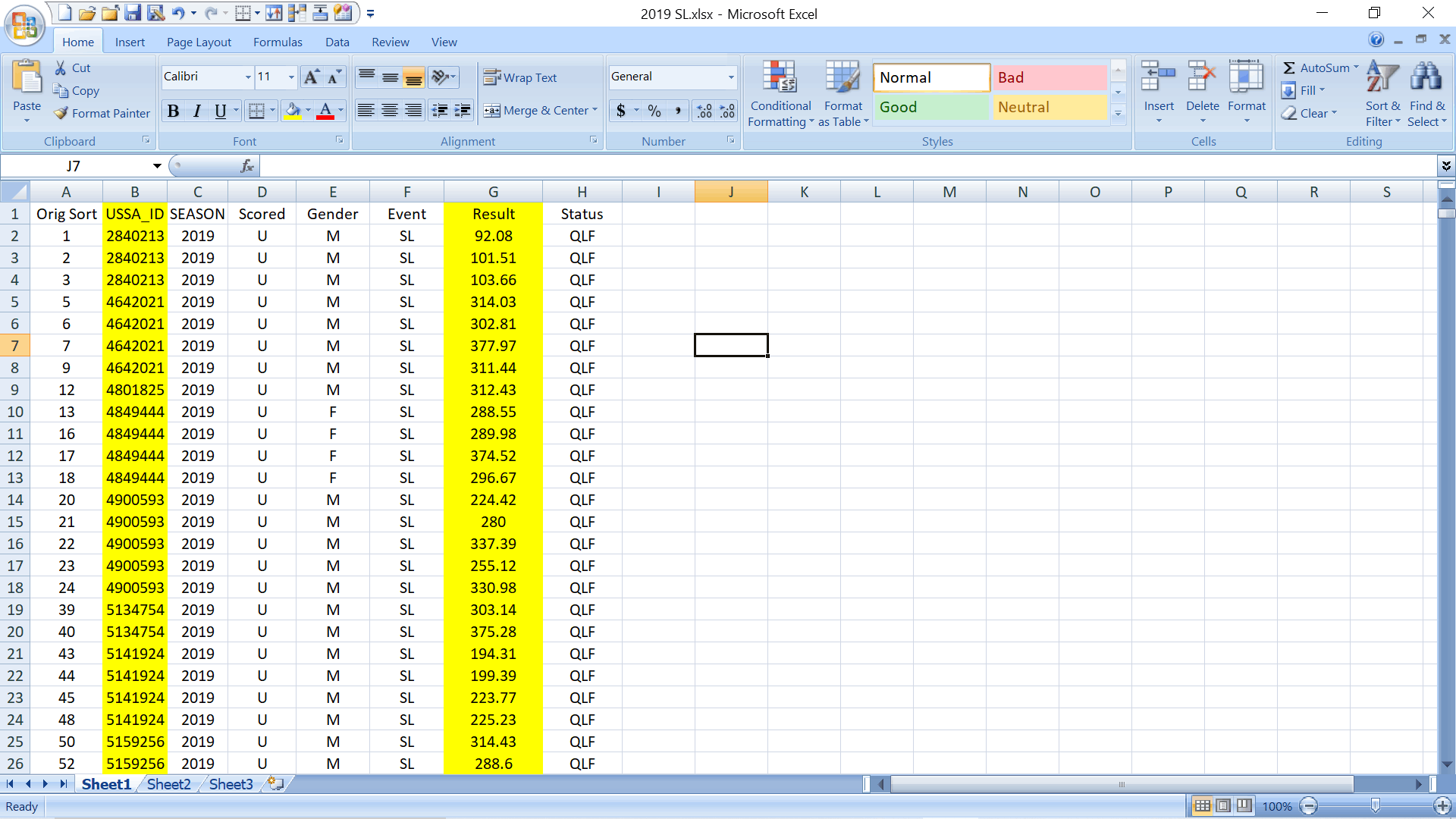

I have some experience with Excel. I haven’t used VBA from MS, and I haven’t written macros in any spreadsheet. I was given a new task with 4 years of data, and I need to find a way to sort and compile the data - in a manner I haven’t done before. Some of the files have over 30,000 rows of data.
The basics are:
Sheet 1 - raw data
Column B = member ID (with each member ID most likely appearing on multiple rows)
Column G = member’s evaluation for each appearance of member ID
Sheet 2 - compiled
Column A = member ID (only one occurrence to reference the raw data)
Columns B - Z (or more) = each evaluation of a the member (so a member could have 1 evaluation, or 20+) transferred from sheet 1
Image attached of the Raw Data sheet.

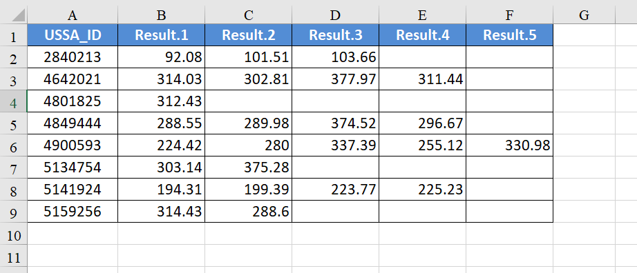

    As per your description, it seems your desirable output will look like the one in the picture below
    If so, we might have 4 ways to achieve your goals
    Pivot Tables, Power Query, VBA macro, and Array Formulas.

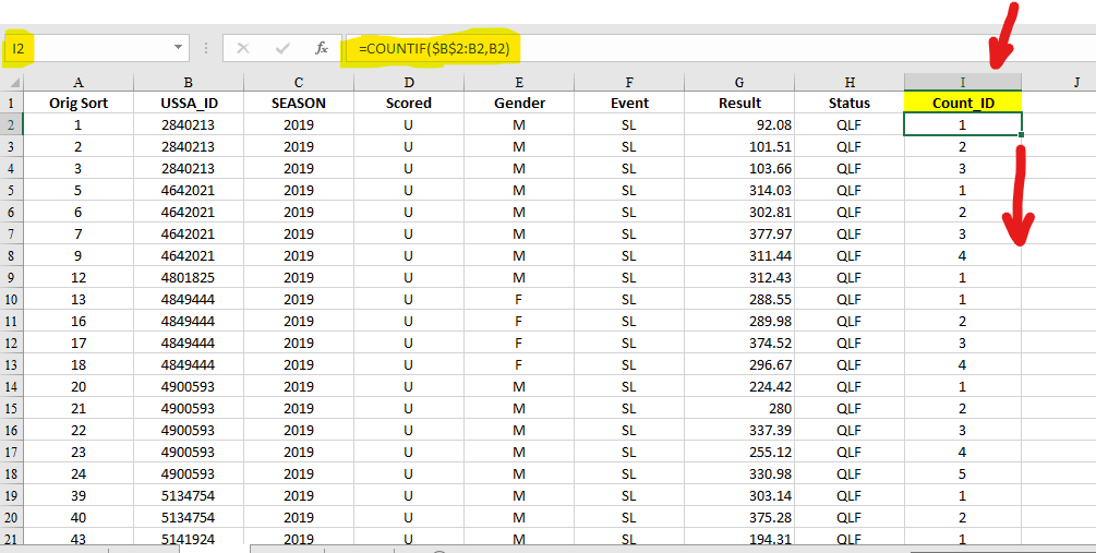

    a) Add a helper column to your original table to calculate the running count per ID with the formula =COUNTIF($B$2:B2,B2). and copy it down
    Adapt ranges in the formula to your real scenario

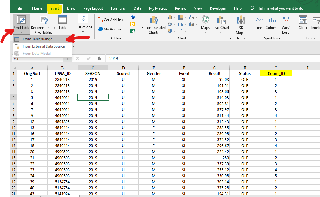

    b) Convert your table into an Excel Table and create a Pivot Table
    Select any cell within the table >> go to Insert ribbon Tab >>Insert Pivot Table >> From Table/Range
    c) Make sure the entire table is selected/highlighted. Set the Pivot table to another sheet.
    d) To build the Pivot Table select and drag the highlighted fields to the areas as indicated in the picture below
    and VOILA!!!

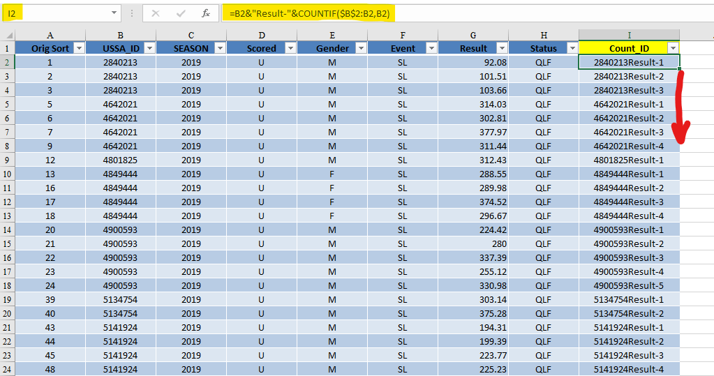

    Using the same helper column (Count_ID) with a little twist in the formula
    =B2&"Result-"&COUNTIF($B$2:B2,B2)

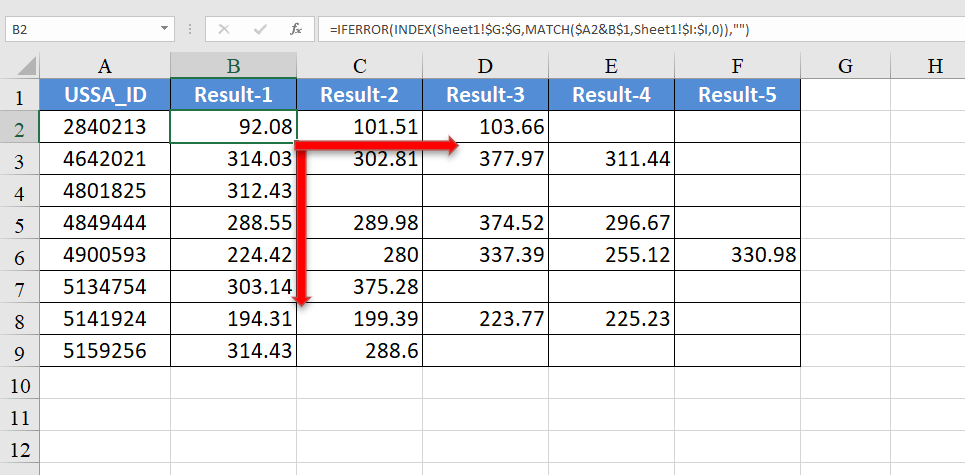

    Considering you have already the list of Unique ID
    =IFERROR(INDEX(Sheet1!$G:$G,MATCH($A2&B$1,Sheet1!$I:$I,0)),"")
