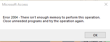

Programming in Access 365 but it is a 32-bit access front end with a SQL Express backend. Been using this database for years with no issues. All of a sudden starting approx. last Monday 12/12/2022 we started getting out of memory errors on the client side. Users started getting it randomly over 2 or 3 days as if it was an update.
If I open the database and watch task manager, as I open forms and close them, I see the memory usage go up when the form is opened as expected but it never goes back down to where it started from when the form is closed. We have a few form timers that run code every 2 to 5 minutes and the same thing happens, memory usage goes up when the timer triggers but when the code finishes the memory is not released.

    I have checked the Access Blog and the last update I see was on December 19th. Any updates on this issue? Are you still getting reports of this issue, have you been able to recreate it? We are still having the out of memory error. Please advise.

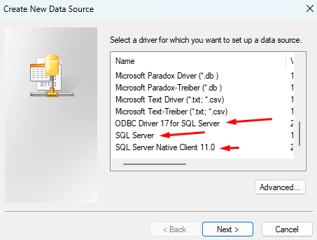

    Also note the database is connecting with 'SQL Server Native Client 11.0'. I have also tried 'ODBC Driver 17 for SQL Server' and the 'SQL Server' drivers and have the same issue with all three.
