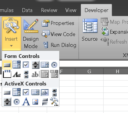

I just created a button to launch a Macro that runs the solver. But when I click it, it doesn't run. I see it click, but no action occurs. The VBA code behind the macro is very simple:

I've confirmed that the macro works when I run it manually. I've enabled everything I know how, but I still can't launch the Solver from this button. Does anyone have a clue what might be wrong?

Re: "the macro works when I run it manually"
You may be using an ActiveX control, which takes some additional work to make it function.
Try using a Forms Control button
Nothing Left to Lose

    2022-06-22T02:57:02+00:00
    Yup! That solved the problem! Thx.
    You are welcome.
    2022-06-21T23:16:16+00:00
