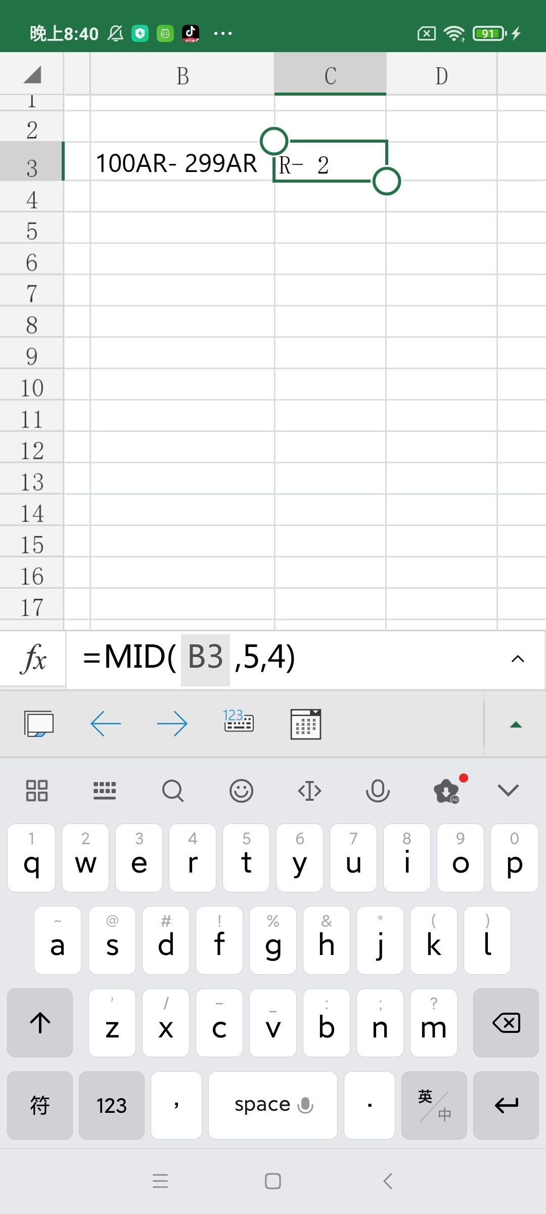

    if the 5-9 characters were in the 100AR- 299AR?(sorry I do not get the meaning)
    5-9 characters is mid("100AR- 299AR",5,4)=R- 2
    why R-2 result to Federal Funded - Agriculture?
    rather than AR?characters 4-5

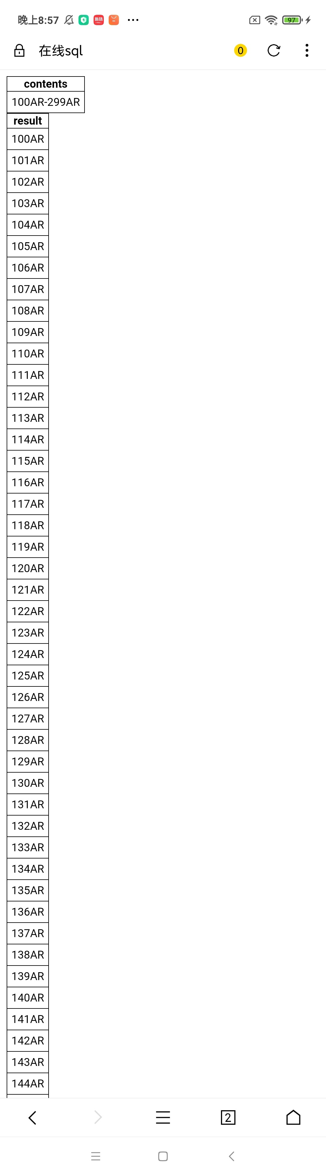

    100AR-299AR original
    serial
    become
    discrete value

    original data
    100AR- 299AR series
    expected result
    Agriculture
