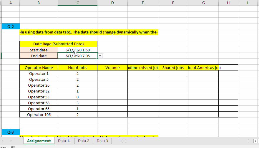

Update the below table using data from data tab1. The data should change dynamically when the date range is changed
2022-11-18T05:12:03+00:00
Date Rage (Submitted Date)
Start date 6/1/2020 1.52
End date
Operator Name No.of Jobs Volume Deadline missed jobs% Shared jobs No.of Americas job
Operator 1
Operator 5
Operator 26
Operator 32
Operator 53
Operator 58
Operator 65
Operator 106

    The 1st step is to correct the data:
    After that we can use simple COUNTIFS or SUMIFS formulas:
    C27: =COUNTIFS('Data 1.'!B:B,B27,'Data 1.'!E:E,">="&$C$23,'Data 1.'!F:F,"<="&$C$24)
    Sample file: https://1drv.ms/x/s!AsEpmlJLteasji2tf-MdqzVM69aT?e=d5zVlL

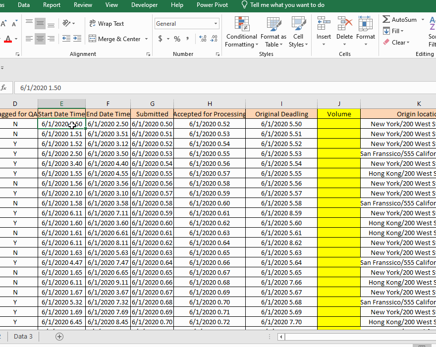

    It is not possible to perform this operations with the data as it is. The reason is that your date/times are text, not real date and times.
    "6/1/2020 1.52" is a text, we can guess that this means 6th January 2020 1:52 AM but is can also mean 1st June 2020 1:52 PM or...
    Date and times in Excel are in fact a number, for example enter the formula =NOW() into a cell and you'll see the current date and time (based on your lcoale settings). If you format the cell as General you can see the number that Excel uses.
    Andreas.
