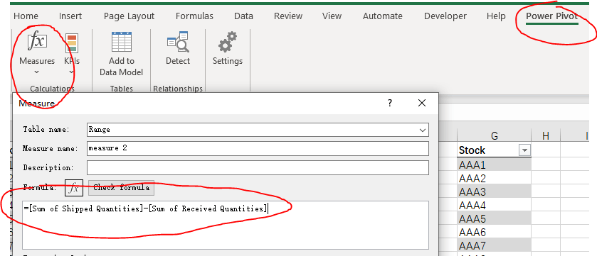

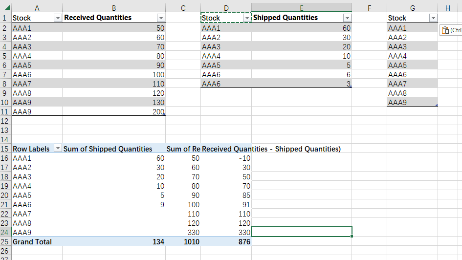

Hi Basil,
Based on your description, you have two report and want to get the balance quantities.
Here is the result.
Steps:
1.get a list with unique value of stock (Table3)
2.Create data model and choose "table 3"
3.Create relationship for Table 1 and Table 2 with Table 3
4.Select the Sum of shipped quan and Sum of received quan

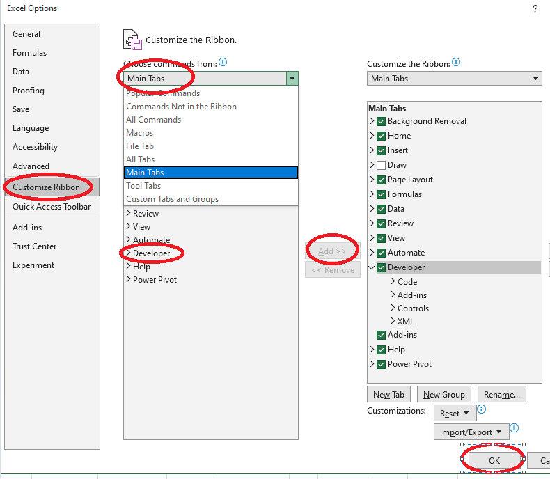

5.Choose the power povit add for excel add in from developer
6.Add Measures to power povit
Hope it helps. Let me know if you have any problem.
