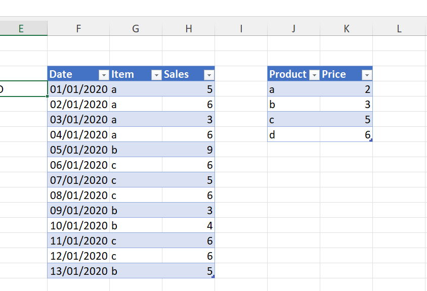

I'd like to multiply different sized array based on a condition, I've made some attempts using switch,
SUMPRODUCT(SWITCH(Table1[Item],"a",2,"b",3,"c",5,"d",6),Table1[Sales])
But this is not ideal and also I'd like to get the result for each Item, a b c and d .
I'm looking to get a total for each item, I was thinking if I could wrap the above in a IF statement,
IF( X ="a" , Sumproduct, if = "b" etc. , but the formula would still be returning the full amount.
The closest I've got so far is but the array { litems} doesn't seem to work, thought it might, so works fine for each 'a' but then I still need to sum the group?
IF(G4= {"a","b","c","d"},H4*SWITCH(G4,"a",2,"c",5,"b",3,"d",6))
could do with some fresh ideas.
Richard

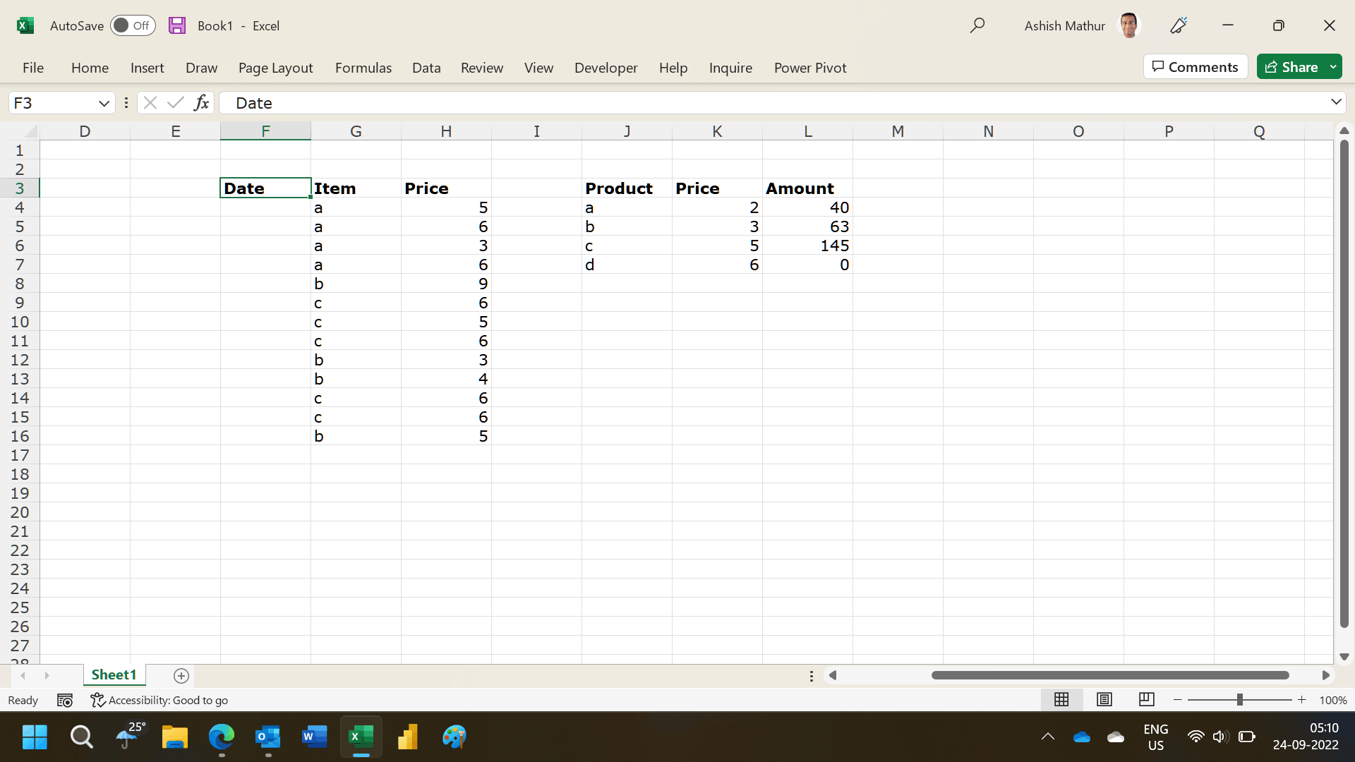

    In cell L4, enter this formula and drag down
    =SUM(FILTER($H$4:$H$16,$G$4:$G$16=J4,0)*K4)
    Hope this helps.

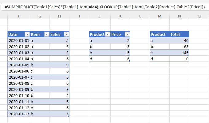

    In the screenshot below, the formula in N4 is
    =SUMPRODUCT(Table1[Sales]*(Table1[Item]=M4),XLOOKUP(Table1[Item],Table2[Product],Table2[Price]))
    If you don't have Microsoft 365 or Office 2021, you may have to confirm the formula with Ctrl+Shift+Enter.

    2022-09-24T11:52:11+00:00
    Works brilliant, will try filter method,
    I did change the Boolean part to a double negative rather than multiplication, I've just always --( ,
    also, in the xlookup I've not used an array as the lookup value so will have to look into that a bit more. One last thing, ( office 365) , if you use ctrl. shft enter on an array this now stops the spill and just gives the 1st result in a single cell which can be useful.
