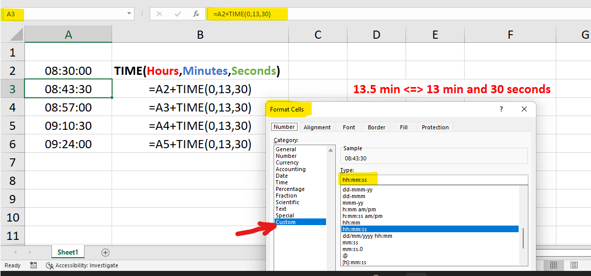

I have a starting time for a process which iterates every 13.5 minutes . Assume the starting time is 8:30 AM . I need to add 13.5 minutes to 8:30 to get the time of the first iteration. In this way I can know the time of every iteration through the work day . It is a simple problem but I can't seem to get the formatting right . Can somebody younger than I figure this out? I'd appreciate that a lot.
    2022-07-14T22:47:01+00:00
    Hi Lynn
    Assuming the starting time 8:30 AM is in cell A2
    Try the formula =A2+TIME(0,13,30) and format the cells as described in the picture below
    I hope this helps you and gives a solution to your problem
    Do let me know if you need more help
