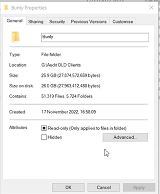

    From the screenshot you shared, we can see that there are 51,319 files in the folder. Considering that same situation appears in different browsers, we're afraid SharePoint is getting throttled.

    This particular folder has more than 51 K items and multiple sub folder into it.

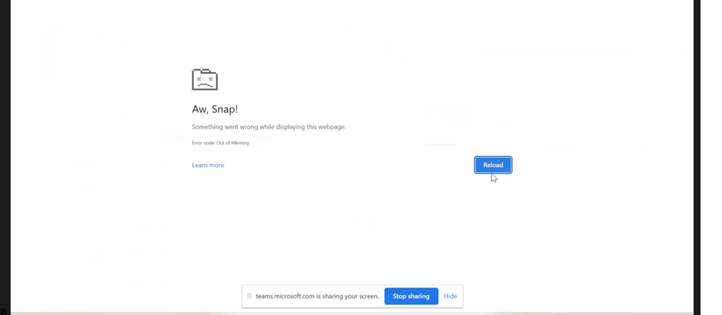

    Yesterday, I tried to upload them again, and UI was showing that, more than 51 items were uploading, and then got the same error:
    Out of memory.
    I tried on both Chrome and Edge.

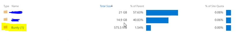

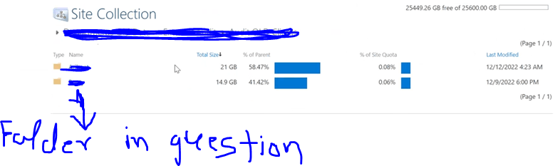

    When I checked the storage metrics, it shows 575 MB, but actual size is 25 GB.
    Looks like, due to multiple folders and subfolders, SharePoint is getting throttled.Image
