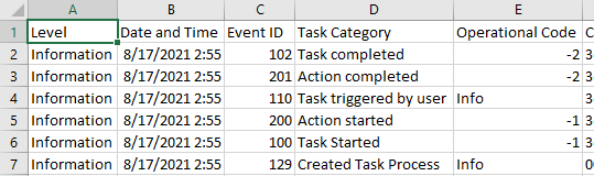

and this is the Task Scheduler History:
and I'm running the task as Administrator.

  1. RLWA32 49,541 Reputation points
    2021-08-17T09:36:38.997+00:00
    When you do not specify a "Start In" location for a scheduled task the task scheduler will set the current directory to the System32 folder (usually C:\Windows\System32") for the process that it starts. Have you looked there for the expected log file?
    Also, if your scheduled task is running a 32-bit process then the output file will be in the SysWOW64 folder.
