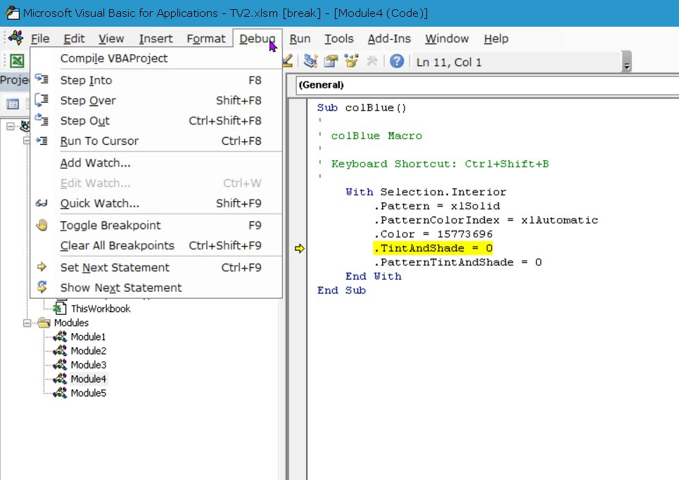

    Go into the macro editor
    Put the cursor at the start of the macro
    <F5> will run the macro
    <F8> will advance 1 line (execute current line, move to the next line
    You can set "watch points" , or "break points" (to stop execution), you can type commands into the "Immediate" window to see values.
    https://www.myonlinetraininghub.com/debugging-vba-code
    https://www.tutorialspoint.com/excel_macros/excel_macros_debugging_code.htm
    https://www.mrexcel.com/excel-tips/debugging-vba-macro/ (video and example file https://corporatefinanceinstitute.com/resources/excel/study/vba-how-to-debug-code/
    https://www.excel-easy.com/vba/examples/debugging.html

    Hi, I'm Elise, and I'd be happy to help with your issue.
    That is right, if you set a breakpoint in the code, then you can just step through the code using F8
    There is a good guide here on other methods too:
    https://www.wiseowl.co.uk/blog/s196/step-throug...

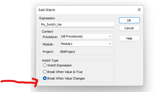

    > ...My target is to understand how a switch is getting set, that is supposed to be set by the user in the MAIN routine.
    Just another idea is to right-click your variable and add it to the Watch list.
    You can just run your code normally, and it will break when the value changes.

    Rand2201 Thanks for your reply.
    I Developer>visual basic>Debug>Add watch. How do I find the switch I want to watch? I know its name with the spreadsheet, but not in Debug?
    Thanks. SweetTasha
