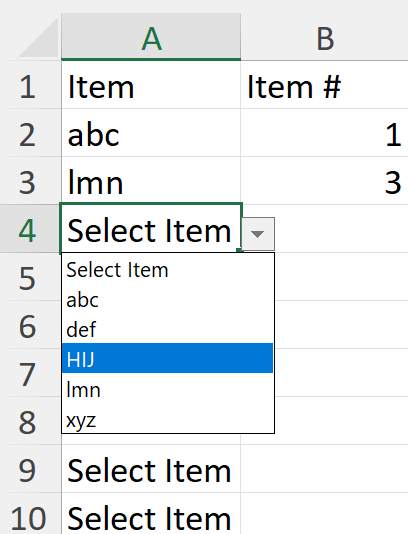

    Here is something that might work for you if you are using 365.

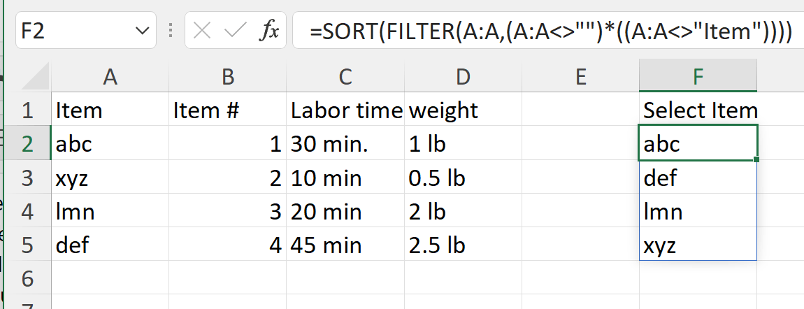

    Create your Materials sheet in whatever way you want, but let the first column be the one you will use to enter an item over on your work sheet. Create a sorted list as seen in F:F of the column A:A or whichever column you listed first - note, that every item in this list must be unique - you can not use the same name more than once.
    This example uses the Item name list. The FILTER function is used to exclude the column header ("Item") and blank rows. SORT ensures that the items are listed alphabetically. Notice that this formula is in F2 - the header "Select Item" was hand-typed.
    =SORT(FILTER(A:A,(A:A<>"")*((A:A<>"Item"))

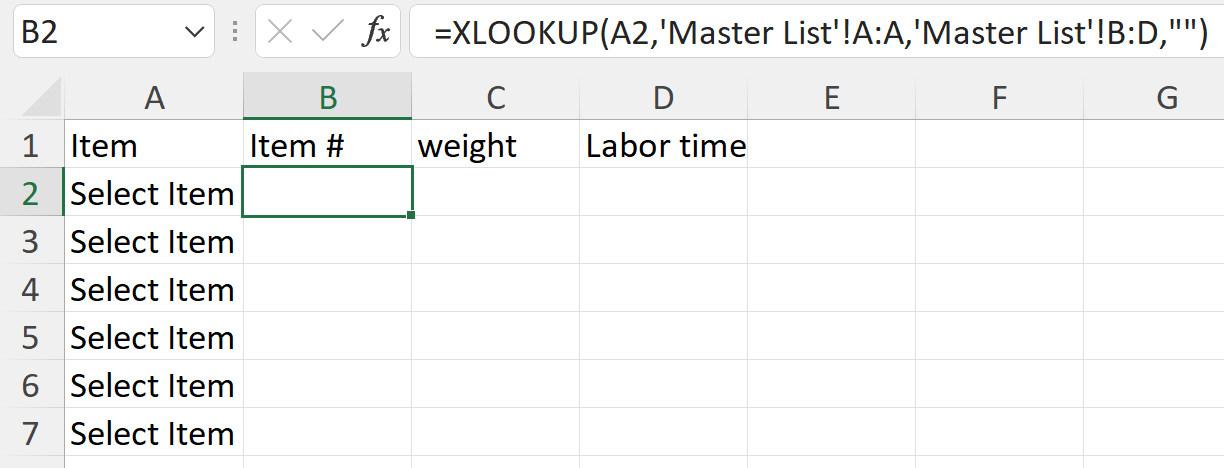

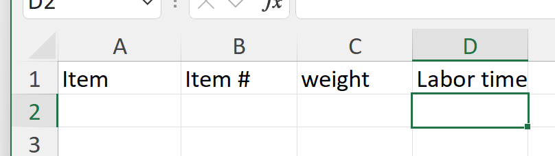

    Move over to your worksheet and set it up with the lookup item listed first followed by the items to be loaded automatically - notice that it does not matter which order the items in the header are located.

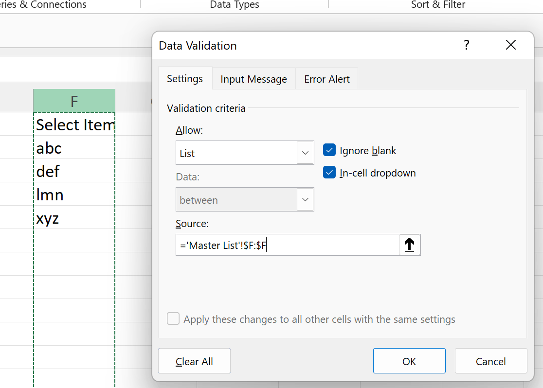

    Click in cell A2 and create a Data Validation list - in the Data tab, under Data Tools, select Data Validation. Under Allow, select List; next, click in the Source box; then select the sheet where the materials list was prepared, followed by the column where the Select Item list was prepared. Click OK.

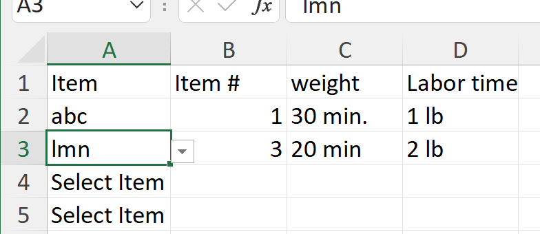

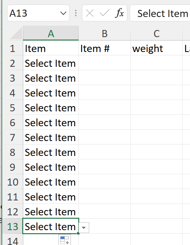

    Back in the Worksheet, select "Select Item" in the dropdown list in A2; then with that cell selected, FILL DOWN to as many cells below it that you wish to be able to look up an item.
    Place the following formula in B2 and FILL DOWN to as many rows that have a "Select Item" drop down list in them.
    =XLOOKUP(A2,'Master List'!B:B,'Master List'!A:D,"")
    Whenever you select an item from the drop-down list in column A, columns B, C, and D enter automaticall.
    And, due to the way things were set up in the sorted list in the materials page and since the data validation box used the entire column, if you add a new item to the materials list, it populates into your Select Item drop-down lists automatically.
