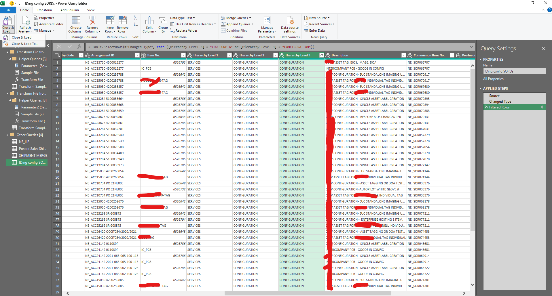

Now I need to remove the items for all NE_SORs which have not come through our configuration center. In order to identify what NE_SORs have come through config and what hasn't I can create a new query 'From Table/Range' and filter the 'Hierarchy Level 3' column on Configuration. 'Close & Load To' -> 'Connection Only'. This gives me a list of all NE_SORs which have come through configuration

    2022-05-27T15:21:48+00:00
    Here is how I identify the config NE_SORs
