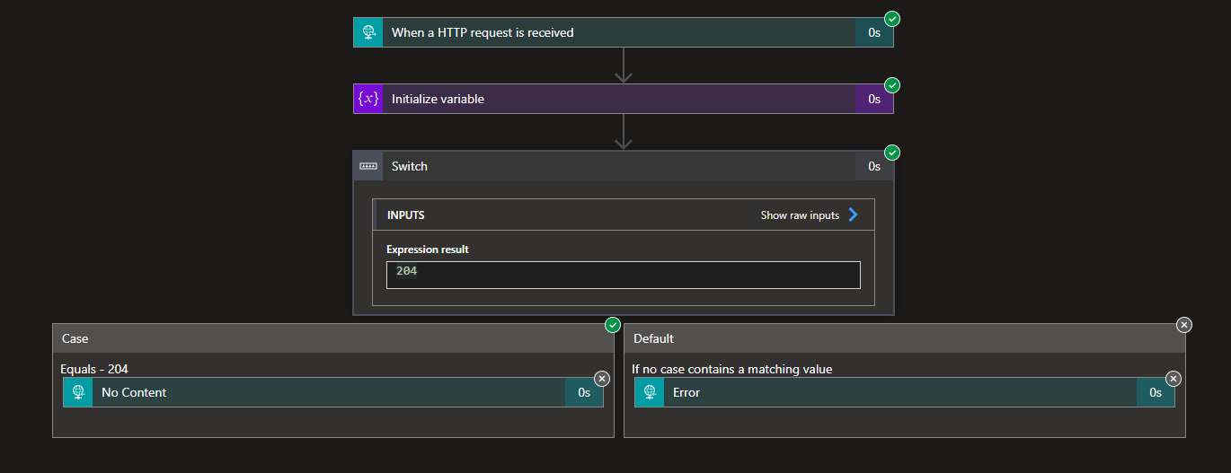

When debugging a Logic App Run online, a Switch action sometimes marks the Default as being ran with a green question mark instead of the case that was executed. I noticed this mainly when the switch is on a string that contains digits only. Attached is a screenshot.

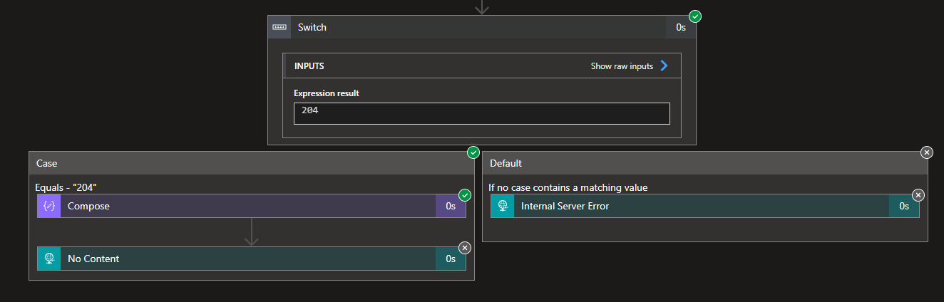

    @Thomas Johnson This is likely because of the types like you've mentioned. If the input is the string of a number, you need to compare against the expression string(204) instead of just 204. Or the other way of comparing the expression int(<token>) to the numbers the way you have now.
  2. Thomas Johnson 66 Reputation points
    2021-11-23T14:03:53.68+00:00
    Thank you. This is a good "workaround" to getting the debug page to display correctly.
    I still think the debug page should display correctly without us adding "extra" code.
