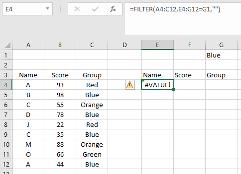

Hello - I want to use the FILTER function to enter row data into a new sheet. I am trying out the basic FILTER function formula first and getting a #VALUE! error. Not sure where I'm going wrong. Thank you.

    I think you want
    =FILTER(A4:C12, C4:C12=G1, "")
