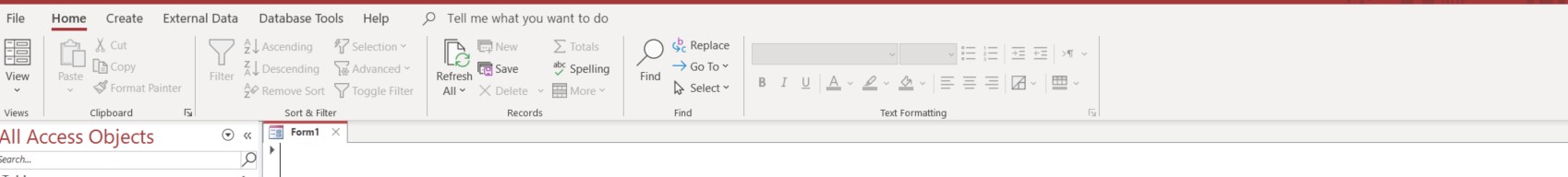

I have a database with a link to a sharepoint list. When I tried to append to this list using a query, the following error seen below is displayed on my screen. Typically when I try to append there will be a couple thousand records and it will append some records but not all at once. How can I fix this error?
