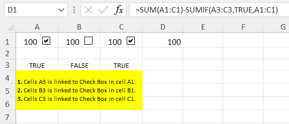

I would like to build a formula where the total amount will add or subtract based on whether a checkbox or command is entered in a cell next to the amount, for example; if I have 3 columns with €100, then the goal is for the column with the grand total of €300 to subtract by €100 for every box checked.

    Please check whether the following solution is helpful:
    Formula in cell D1 is: =SUM(A1:C1)-SUMIF(A3:C3,TRUE,A1:C1)
    Please respond if You require further assistance. I will try My best to be of help.

    2022-05-24T10:30:16+00:00
    This was exactly what I needed.
