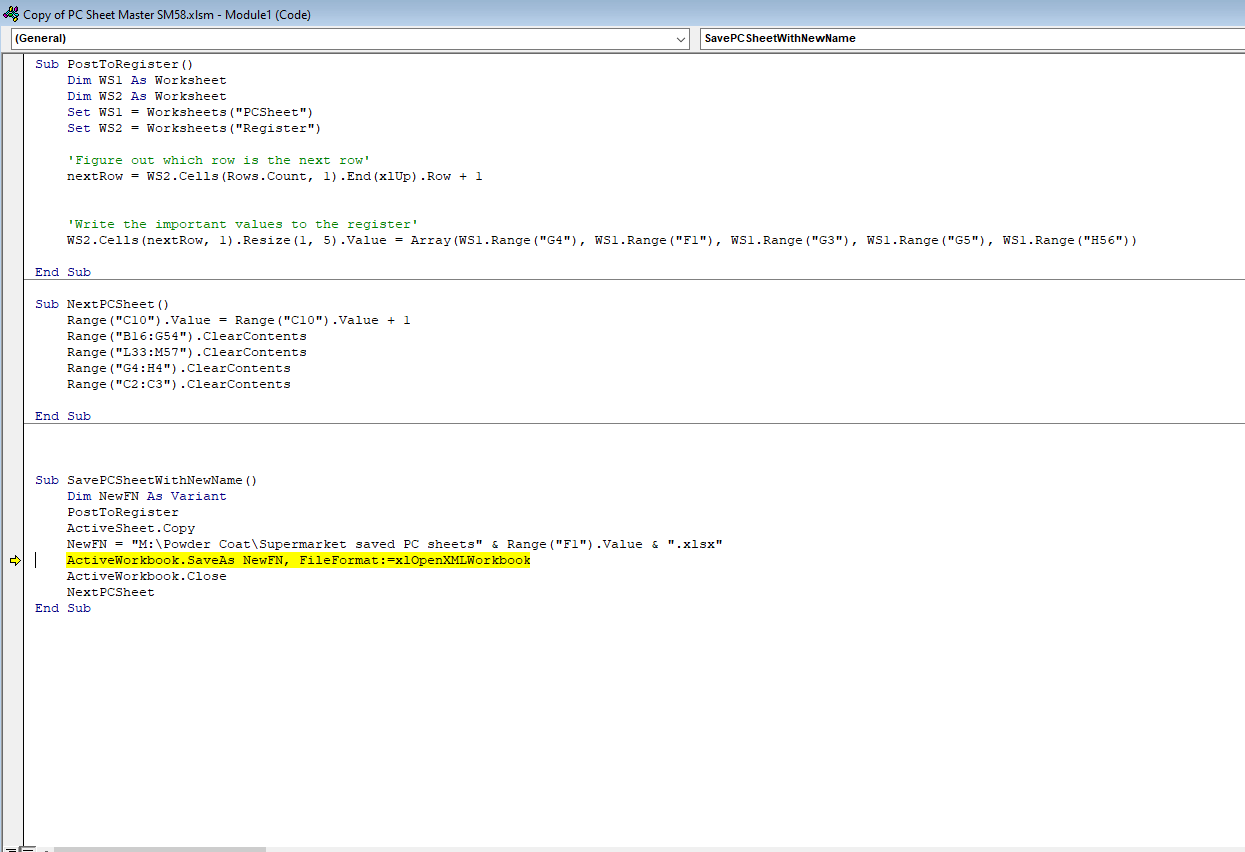

Getting run-time error '1004': document not saved error when trying to save and create new sheet number. Can someone please help?!
2022-05-18T11:08:52+00:00
this is the vba code that is pulling the error highlighted

  1. OssieMac 47,981 Reputation points Volunteer Moderator
    2022-05-18T11:19:32+00:00
    You are assigning xlsx extension to the file name variable and trying to save a workbook with vba code that needs to be xlsm extension.
    Also, the file format for macro enabled workbook is FileFormat:=xlOpenXMLWorkbookMacroEnabled

    Would this be correct then?
    Sub PostToRegister()
    Dim WS1 As Worksheet
    Dim WS2 As Worksheet
    Set WS1 = Worksheets("PCSheet")
    Set WS2 = Worksheets("Register")
    'Figure out which row is the next row'
    nextRow = WS2.Cells(Rows.Count, 1).End(xlUp).Row + 1
    'Write the important values to the register'
    WS2.Cells(nextRow, 1).Resize(1, 5).Value = Array(WS1.Range("G4"), WS1.Range("F1"), WS1.Range("G3"), WS1.Range("G5"), WS1.Range("H56"))
    End Sub
    Sub NextPCSheet()
    Range("C10").Value = Range("C10").Value + 1
    Range("B16:G54").ClearContents
    Range("L33:M57").ClearContents
    Range("G4:H4").ClearContents
    Range("C2:C3").ClearContents
    End Sub
    Sub SavePCSheetWithNewName()
    Dim NewFN As Variant
    PostToRegister
    ActiveSheet.Copy
    NewFN = "M:\Powder Coat\Supermarket saved PC sheets" & Range("F1").Value & ".xlsm"
    ActiveWorkbook.SaveAs NewFN, FileFormat:=xlOpenXMLWorkbookMacroEnabled
    ActiveWorkbook.Close
    NextPCSheet
    End Sub
